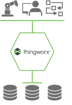

Cold Standby
ThingWorx installed in a default single-server configuration is not inherently a cold standby system. Periodic system backups can be used to bring the system back online in the event of system failure.
Note: A cold standby configuration does not constitute high availability

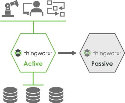

Active-Passive
High availability can be achieved with an Active-Passive configuration.
One “active” ThingWorx server performs all processing and maintains the live connections to other systems such as databases and connected assets. Meanwhile, in parallel, there is a second “passive” ThingWorx server that is a mirror image and regularly updated with data but does not maintain active connections to any of the other systems.
If the “active” ThingWorx server fails, the “passive” ThingWorx server is made the primary server, but this can take a few minutes to establish connections to the other systems.

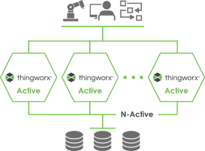

Active-Active
ThingWorx uses Active-Active architecture for achieving high availability.
Active-Active configuration differs from Active-Passive in that all the ThingWorx servers in the cluster are “active.” Not only is data mirrored across all ThingWorx servers, but also all servers maintain live connections with the other systems. This way, if any of the ThingWorx servers fail, the other ThingWorx servers take over instantaneously with no recovery time.
Because all ThingWorx servers are active and processing data in parallel, the cluster can handle higher loads than the single running server in an Active-Passive configuration. An Active-Active deployment leverages the investment made in multiple servers by providing not only greater reliabilility, but also giving the ability to handle demand spikes. When server utilizations exceed 50%, customers can easily scale their deployment by adding more ThingWorx servers to the cluster - horizontally scaling. This also avoids the limitations of vertically scaling - provisioning a single server with more and more CPU cores and RAM.
Benefits of Active-Active Clustering
  • Higher Availability You can avoid single points of failure and configure the ThingWorx Foundation platform in an Active-Active cluster mode to achieve the highest availability for your IIoT systems and applications.
  • Increased Scalability You can horizontally scale from one to many ThingWorx servers to easily manage large amounts of your IIoT data at scale more smoothly than ever before.

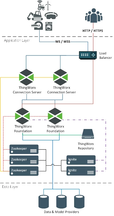

Step 2: ThingWorx Active-Active Architecture
An Active-Active Cluster configuration introduce two software components and two components that are optional in a standard ThingWorx architecture are now required.
The reference architecture diagram below shows ThingWorx deployed with multiple ThingWorx Foundation servers configured in an Active-Active Cluster deployment.
Note: This is an example of a possible ThingWorx deployment. The business requirements of an application will determine the specific configuration in an Active-Active clustered environment.
  • Load balancer was optional in a single-server deployment, is now a requirement.
  • ThingWorx Connection Server is also now required.
  • Apache ZooKeeper is used to coordinate multiple running servers.
  • Apache Ignite is used to share current state between servers.
 Component       Description                                                                                          Provider
Load BalancerDistributes network traffic to servers ready to accept it. In Active-Active Cluster configuration, the load balancer is used to direct WebSocket based traffic to the ThingWorx Connection Services while user requests (http/https) traffic is directly distributed to the ThingWorx Foundation servers.Example load balancers:
  • HA Proxy
  • Azure Application Gateway
  • AWS ALB
See the ThingWorx High Availability Documentation for details.
ThingWorx Connection ServerHandles AlwaysOn connections with devices and multiplexes all messages over one connection to ThingWorx Foundation Servers. In an Active-Active configuration, it handles all WebSocket based traffic to and from the ThingWorx Foundation Server.PTC
Apache ZooKeeperA centralized service for maintaining configuration information, naming, providing distributed synchronization, and providing group services. It is a coordination service for distributed application that enables synchronization across a cluster.Apache Software Foundation
Apache IgniteUsed by ThingWorx Foundation Servers to share state. It may be embedded with each ThingWorx instance or can be run as a standalone cluster for larger scale.Apache Software Foundation
Data and Model ProviderProvides persistent storage of application data.All ThingWorx 9 supported database options:
  • PostgreSQL
  • Microsoft SQL Server
  • Microsoft Azure SQL
  • InfluxDB
    (only available as a data provider)
