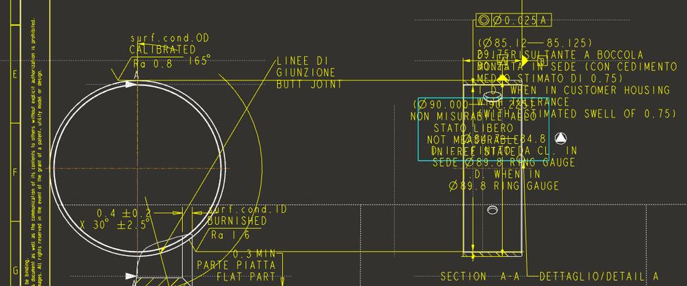

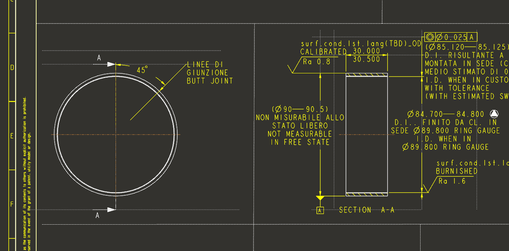

I have a small problem: the position of my note attached to an aperture of an angle it moves "randomly" when changing the value of the angle. Is there a method or a tip to keep it "fixed"?
See my example bellow: when the angle becomes 78deg instead of initially 45 deg, the notes goes way up along with the snap line attached to the view boundary without reason...

When the angle is 105deg, all becomes like this (see the attachment). Observe the dimension line on the right view: what does that dimension (of the width) has to do with a plane??
Your note is snapped to the snapline at the top of your view (which also holds the section marker D-D)
As for the dimensions going whack...your can snap the end of the extension line of the dimension to a snap line.
Creo resizes planes to match the part extents unless the plane is set to a particular size or to match some piece of geometry. All planes can be affected.

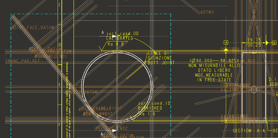

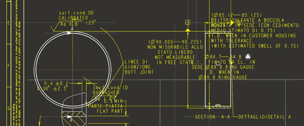

Okay. i tried all four solutions. As you can see, the problem is not only the note, but the whole geometry, in all views. As you can see on the right view, the roughness symbol moves a lot, the dimension lines, the notes... Everything moves around a lot. I mean, A LOT!!

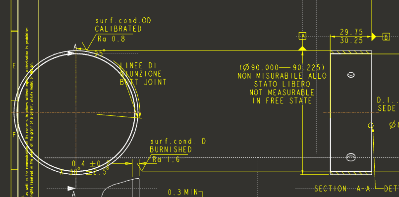

One: there are too many planes to redefine them one by one. Is there a solution to modify them automaticaly?1.PNGTwo: it looks better but I have the problem with the roughness in the right viewPartial ViewPartial ViewThree: I added a snap line passing in the middle of the circle. The geometry varies a lot, so the distance from the plane will change. i suppose it can't be related to the diameter of the circle. Still problems with the right view:Right view notes move aroundRight view notes move around
Four: still the right view...Roughness notes move a lotRoughness notes move a lotThese are my "experiments"...
