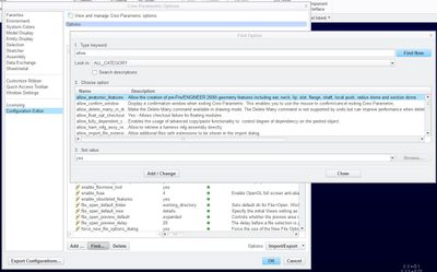

Hi TomD.inPDX,
How do I  get to allow_anatomic_features ?
Thank you.
Best,
DC
TomD.inPDX
(To:DCllc)
That would be set in the config.pro file.
I suspect this needs to be active at your Creo session startup.
That means you will need to save this option to your config.pro file.
You can do this right from this dialog (below) by allowing Creo to save your current configuration.
However, be sure to close Creo and re-open it and confirm the setting took (scroll through the options list).
You should now be able to find more surface features for the ribbon.
Thanks TomD.inPDX.
I found allow_anatomic_features and tried to Add/Change the value to yes.
Unfortunately, upon restarting Creo the setting does not take.
Note, when prompted to save, I've tried both without changing the name, and also saving it as "config_20180427.pro". Either way, when I try to import the newly saved configuration, none of my newly added settings are there (the anatomic features and a tester to see if it would also take).
This seems like an entirely different issue, but maybe you've seen this before?
Thank you for your time.

When Creo starts, it looks for a file named "config.pro" in the startup folder that the Creo program shortcuts points to.  If that file does not exist, save the file under that exact name in the default working folder.  Now when you restart Creo, all the settings (at this one) will be read into the configuration of the session.  this is the primary way to customize your Creo environment.
I have a fairly long list of things in my config.pro.  I am very conscious to -not- overwrite it with temporary settings.  If I want to permanently add a setting to my master config.pro, I simply edit it manually.
To clarify what Tom's referring to:
  • Creo will not load any config file automatically unless it's named config.pro
  • Creo will only load config.pro from 3 places, in this order:
    • The text folder in the installation directory.  That's C:\Program Files\PTC\Creo 4.0\MXXX\Common Files\text for a default Creo 4 install, where MXXX is the build number that you've installed.
    • The user's Home directory, as defined by Windows environment variable
    • The folder specified by the "Start In" field in the properties for the icon used to launch Creo.
You need to save your settings to a config.pro file in one of those locations for it to load at startup.

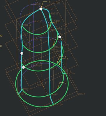

dgschaefer,
Took your advice and still nothing! I notice that the preview of the Boundary Blend will stop once I click the fourth side profile. It doesn't matter which order I pick them in, it always stops showing the preview after the last one. (See attached)
Thank you for your time!
Best,
DC

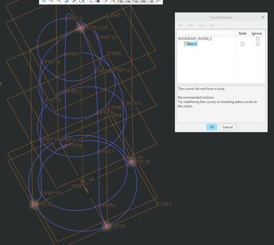

dgschaefer
(To:DCllc)
First, I'd try to build this in smaller pieces.  At least in half, but perhaps one vertical segment at a time.
Second, when I try to build half, it's giving me an error that the curves don't form a loop, even though when I measure the vertexes they show zero distance between them.
Here's what I tried to build:
And here's the error:
I don't have time to spend diagnosing further, sorry.  I'm guessing that trying smaller pieces will help determine where the issue is.
Organic surfacing is not simple stuff, issues like this are not uncommon.
Doug Schaefer | Experienced Mechanical Design Engineer
LinkedIn
I am having the same problem with Creo2.  If you define the boundary blend in both directions, it doesn't like the closing point feature.  Change that point to a circle and it will resolve.  Then you will need a patch for the tip.
These kinds of closed boundaries have always been problematic for core-Creo/WF/Pro|E.
I still think this is so that you will buy the extension.  Or drive yourself nuts with Solidworks instead 🙂

Hello All,
I wish there was a way to mark multiple answers as the solution because it took most of your help to get this done! See attached for your reference.
I built up the finger layer by layer until I noticed the problem area: the 'point' of the finger. I used a circle sketch (which I later put a diameter of 0.01mm) and switched the direction of the chain. I picked the tiny circle and went down to the layer before where as going upward seemed to work just fine for the others.
Filled the top and merged all of them no problem.
