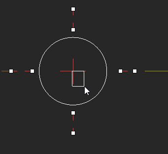

Is there a way I can easily adjust the size of a Center Mark on my Creo 4 drawing besides dragging each endpoint individually?

When I move my cursor to the intersection and try to drag, all I get is a selection box...
please attach a picture describing your "situation".

Thanks for the reply... I did what you say but all I get is the selection box, as you can see in the picture above.

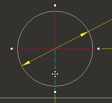

Once you select the axis (single left mouse button click), you should be able to move the mouse back over the axis and you'll get the 4-arrow pointer, then you can LMB click and hold that will move all of them.axisadjust.jpg
Just additional note ...
in doneill's drawing following option is set ... axis_interior_clipping  YES

Ah, I've never used that option, axis_interior_clipping. That makes a mess of my process. I see the same "selection box" as Doneill when that option is set IF I try to select the very center of the axis but I can adjust the "exterior" axis endpoints all at once if I move the mouse over the exterior portion of the axis.

Yeah... I was not getting the 4-arrow pointer until I changed Drawing Properties... axis_interior_clipping to NO.
