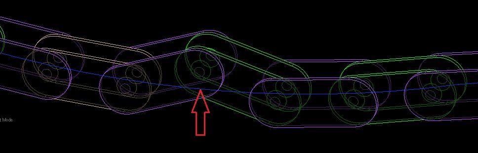

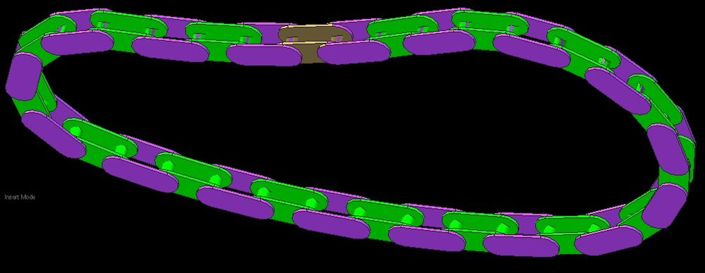

@PM_9971370 Ok, not as perfect as I'd like, but the misalignment on the last pin of the last link is only .0035" MAX (.0002" MIN), so, I'll take it since I'm just doing this for fun.  Should be good enough for now.  First off:
Caveats:
1.  I made links an easy 1" long, not following any actual standard for ANY dimensions (so sue me).
2.  I didn't bother to write a bunch of relations as to overall length by # of links, which won't work anyway - see below).  Feel free to do....whatever.
3.  I picked sprocket size by 2 different arbitrary # of teeth and used the 1" link length x teeth to determine pitch diameter, and used 34 links x 1" to determine the INITIAL perimeter length (which had to be slightly increased - see below).
Ok, so, I was going to try and use a bunch of 1" lines moving along a spline to ACCURATELY determone the shape and length of the perimeter needed (the BIG problem is that it CHANGES depending on how many teeth are engaged per sprocket).  And, well, splines S@CK, what PTC SHOULD have done was make it a POLYLINE which would allow you to constrain (point on entity etc.) these 1" link lines and be able to drag them around.  Nope.  So, back to simply using a perimeter dimension of 34" for the curve.  Then I the first link (gold) with a "planar" and 2 "slot" constraints.  Then I constrained all the next links to use a "planar constraint, a "cylinder" constraint to the previous link, and a "slot" link on the last constraint (far end).  While you can't "pattern" these links, you CAN use the "Repeat" command for all the other links, and you just have to pick one axis for the cylindrical (middle "Add") constraint in the pop-up, so it actually goes really fast.  So, now you can drag the entire chain around (Wheeee!), and every link drags all the others and follows the curve path....except that you notice that the chain is about .1" too long?  What the...?  Well, as you pull the links around, you ALWAYS have axis-to-axis (i.e. link) distances of 1", but since the sprockets are a continuous curve with an arc length GREATER than the combined engaged facets of the polygon a chain sprocket REALLY is, the chain ends up being too long.  How much varies with the # of teeth on the sprockets.  Someone a lot better at math could probably calculate all this to get a "correct length"...aannnd it would STILL be wrong because as I said it VARIES, but I took some measurements, got it to .0002" to .0035" worth of misalignment, and called it done.  At first I let the last cylinder connection float, and got what was shown in the arrow.  But that led my to changing the last 2 links constraints, and allowed me to understand mow much I need to lengthen the "slot" curve.  I used a Skeleton model because I thought the spline feature would work, but that curve could simply be created at the assembly level without the need for a skeleton part at all.  For visuals, I made the FIRST link gold, and for the axiis that have that slight mis-alignment at the last link, I changed the surface colors of those ends of the first and last links so you could measure things easily for yourself.  It IS pretty neat dragging it along the trajectory, and take measurements of the distance between those misaligned axxis as you drag them to different parts of the trajectory.  Anyways, if was kinda fun, not too crazy difficult in the end, took less than a day total, including the limitations in the software mentioned, but I'm satisfied it works for 99% of people, so I'm done.  I even put some "Catenary" drooping for fun for my friends @KenFarley !  LOL  🙂

DunamisMachines wanted a solution where all the link pins lined up for all the links in a path.  What they weren't clear on is that they supposedly had a solution, but wanted something "automatic" where they could simply pick a path, and simply pattern all the links and it would magically make the path length correct and space the links correctly and equally.  I don't know that you'll ever get all that.  What I did was make sure all the link interfaces were perfectly aligned except for the very last interface that CAN'T be perfectly aligned centerline to centerline without that interface NOT following the path.  You have to pick one or the other, and I chose the way I did it.  The worst misalignment I found was about .0035".  Close enough for me.  As you drag it around, it varies, so, you really CAN'T make it perfect, that's the major problem.  It was a mite tedius having to constrain each link individually (though the "Repeat" command REALLY helped), but you simply can't get it to work right using a pattern....not that I found.
I don't use chains either, I just thought it was a good mental exercise and good practice for me since I hardly ever use Mechanism.  Were you able to drag the chain around ok?
PM_9971370
(To:Patriot_1776)
We are able to drag the chain.

Just gave it a whirl.  No flipping at all.  It's heavy, but it functions!  Pretty cool.  🙂

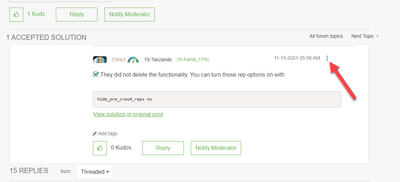

They did not delete the functionality. You can turn those rep options on with:
hide_pre_creo4_reps no

@MODS:  No offense to Chris3, but actually, I very much take issue that this is considered the "solution".  It was a solution to a question I asked, but not the solution to the ORIGINAL POSTED PROBLEM.  I know that lately you want to mark everything as "solved" to make it look like there are no outstanding problems.  But, it is NOT solved, and if you're going to mark something as solved, mark the actual closest solution to the stated problem.
StephenW
(To:Patriot_1776)
@Patriot_1776 As the original poster, you should be able to hit the 3 dots on the "accepted solution" and select "NOT THE SOLUTION"
Patriot_1776
(To:StephenW)
Ah, thanks Stephen!  I didn't know you could do that.  If they want to close it out as "solved" I tried to pick my original post, but it wouldn't let me.  Ah well.

Nice.  Dragging these links around starts to bog down my system, but I'm impressed it works quite well.  I played with it one step further and converted your skeleton sketch into a single spline - but it's funny how you still have to make a multi-selection to form the loop as the software seems to internally convert this loop into two splines (even though 1 is generated by the sketch conversion tool).   Maybe it's some general limitation of the code related to the mechanism and slot connections.
Patriot_1776
(To:pausob)
Yeah, that's what I mean (hence my OTHER thread about this BUG), I did the same thing, thinking the spline would work easier (plus I had an ulterior motive), but it, for some reason, cut it in half, at what looks like an arbitrary location.  Whaaaaat?  Maybe it's related to the fact that since the very beginning (at least V15 where I started back in '86) Pro/E cuts cylinders (and circles) in half like that, causing TONS of geometry failures over the years.  My PC is really old and slow, and it bogged mine a little too, but it does work and didn't flip any links, and is about as accurate as I think you can get because of the software limitations.  I tried to make the links a "Geometry Rep" or "Graphics Rep" to speed it up, but in Creo 4 they got rid of that functionality!!!  *facepalm*  WTH were they thinking?  The "Automatic" rep didn't seem to do anything.  What a joke, that was one of the great features of Simplified Reps.  When I lease a copy, I'm going back to Creo 3.
