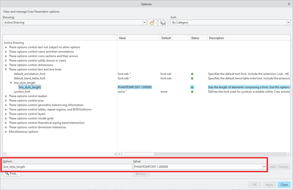

add new option into your drawing - see picture. The value in inches represents the length of line segment.
line_style_length PHANTOMFONT 1.00000

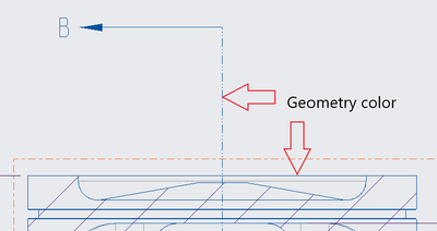

I am sending some information...
1.] Settings inside your drawing cause that cutting line and visible geometry edges are displayed using the same color, the name of this color is Geometry.
2.] By default Geometry color is drawn by pen 1. I uploaded 3 examples of pen 1 width.
My pentable is also uploaded (packed in zip file).
