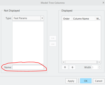

So, I don't know of a way offhand to automatically add that "Component" parameter to any or all components in an assembly, but I tried adding the column to the Model Tree, a trick I've used in the past to add parameters quickly to multiple assemblies/parts, but the only option for showing parameters like that are showing "Model Params" (i.e. "Part" parameters), there IS no "Component Params" option(!!!), so you can't even do that.  Adding it to the Model Tree like that would have been the second best thing to what you want, but you can't even do that.  The caveat to that is that you need to be careful in that using the Model Tree like that it IS easy to add the correct parameter name...but the wrong parameter TYPE (i.e. "Integer" instead of "Real Number" or "String".  Then it's kinda a pain to delete it.  Or so I've been told...  LOL

To add component level parameters to the assembly model tree display, you have to manually type in their name under "Feature parameters"
It makes logical sense because a component placed in an assembly is an assembly "feature".

  8. Ensure that the new Parameter is in the model tree by adding "Feature Parameters" column.  Now the initial values can be easily modified in the Tree.
