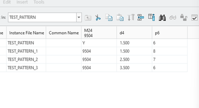

I noticed recently ( I think it has been around awhile) that when you delete an entity that is patterned, it does not delete all the dimension of the pattern.

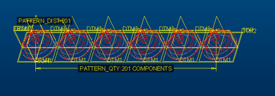

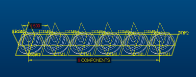

A part is patterned:

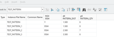

A family table is made:
I renamed the dimension (distance apart and qty) to try and avoid confusion:

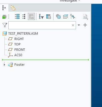

Next I deleted the part that was patterned (which deletes the pattern too).

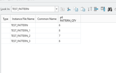

But the family table still shows the qty (and on a different one, it didn't get rid of the dimension):
Is this a glitch?
Dale_Rosema
(To:Dale_Rosema)
Since no one seems to have an issue with this, I am going to say the solution is:
When deleting a pattern part, first delete the pattern, then delete the part and you will not have any stray dimensions in your family table.
