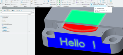

Note also that now the divide surface tool is available to better highlight your design intent:

Designate under Model Intent, added in 3.0, might be a better tool for what you are trying to accomplish.
