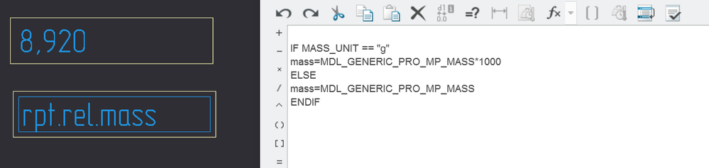

is it possible to perform a calculation based on an if-statement in a drawing repeat region relation?
Prerequisite:
Model units: mm Kg s
I would like to multiply mdl_pro_mp_mass by 1000 if model parameter mass_unit is set to g instead of kg.
Something like this:
mass_display = mdl_pro_mp_mass
if mass_unit == "g"
mass_display = mdl_pro_mp_mass * 1000
endif
It's only the IF that doesn't work; the calculation works fine if tested separately.
It works in a Post Regeneration relation in the model (using pro_mp_mass instead of mdl_pro_mp_mass), but I would like to not add the relation in the model.
Tested on both Creo 9.0.3.0 and 11.0.6.0
Any suggestions?
Thanks in advance! 🖖

Hi
If I understand what you want correctly, try this.
IF MASS_UNIT == "g"
mass=MDL_GENERIC_PRO_MP_MASS*1000
ELSE
ENDIF

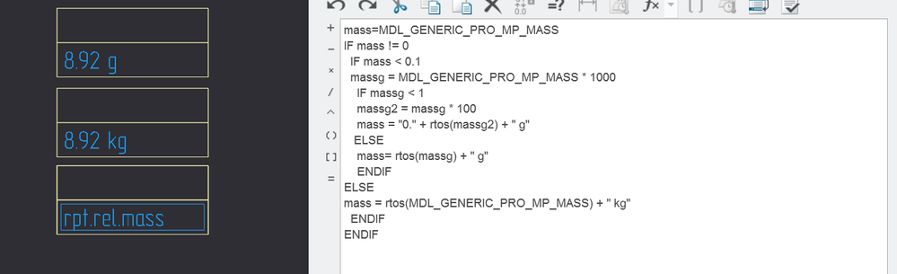

For automatic g/kg switching, I use this
IF mass != 0
  IF mass < 0.1
  massg = MDL_GENERIC_PRO_MP_MASS * 1000
    IF massg < 1
    massg2 = massg * 100
    mass = "0." + rtos(massg2) + " g"
   ELSE
    mass= rtos(massg) + " g"
    ENDIF
ELSE
mass = rtos(MDL_GENERIC_PRO_MP_MASS) + " kg"
  ENDIF
ENDIF

We don't want to change the model units, just choose a different presented unit on the drawing if the model is very small or have a low mass.
Our models span between parts of a gram (small injection molded polymers) to tens of kilograms (casted and/or turned/milled metal) and would like to present the mass accordingly.

C4DG33K
(To:Voronov)
Thanks Voronov,
I got it to work with just minor changes to your relation.
I want to use MDL_PRO_MP_MASS instead of the GENERIC.
The weird thing is that I initially started exactly as your first suggestion, but it didn't work.
Now when I pasted your suggestion it worked... Inscrutable are the ways of Creo! 😜
