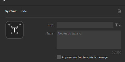

Dom_CHENTRE
(To:Dale_Rosema)
I have a SD XL, and it works fine for map keys.
I'm using this.
It paste all my boring map keys...
Even with "Enter Key" so several Map keys...
Sorry, screenshot is in French...
