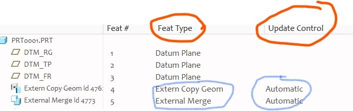

Instead of using reference viewer which gives you a detailed breakdown of external references in your file, you can make use of model tree columns for a quick glance :ext.jpg

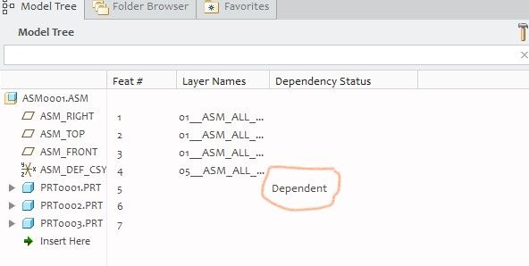

I created three parts. Assembled them in an assembly. Activated first part. Placed one hole on part 1 with reference edge of part 3. Activated assembly and saved it.
Now when I open assembly, everything looks fine. But individual opening of part 1 says external reference missing into message window and that hole feature is also not defined. This is not in case we open assembly as it got reference from part 3.
Can anyone show me how to identify from assembly window that part1 has one feature that is hole which has external references. I do not want to go to reference viewer for each feature of each part.
Attaching sample CAD data for easy and quick reference.
Try this if this solves your issue:
1. In the assembly, add "Dependency Status" to the model tree. You will see the word "dependent" next to prt0001:

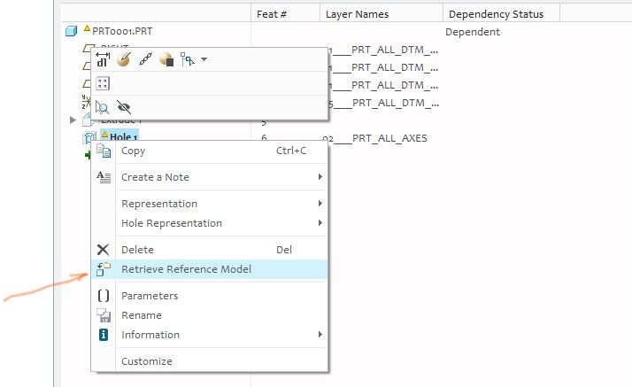

2. When you open up prt0001 w/o assembly, you can always right click to retrieve its reference part/assembly:

wow great BhOoi
Dependent status at assembly level helps me to identify what parts are dependent on others. Here in case it is part 1.
Is there a way to identify that Hole 1 feature of part1 making it dependent?
You need to go to part level to display its feature info, not able to display in assembly level. Th best way is still by ref viewer Smiley Happy

If you referenced via data sharing features, it would be possible to list in part  model tree as shown in my 1st reply. Also, the external references (in this case, the assembly) would be retrieved automatically each time you open prt0001.
May be we should post another question on how to retrieve the external reference in cases like this?
Add Parents Details column to your model tree, if you open the part that has external reference that is not in session, you will see Out of Session. Now RMB on that feature and select Edit References, the Edit References window will show external reference.
