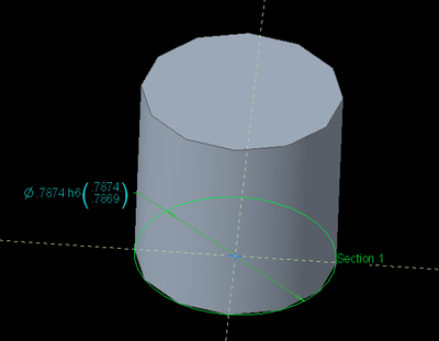

Hi, I think you can get the dimension to behave the way you want if you set the config.pro option maintain_limit_tol_nominal to yes:
(seems the same outcome if you set maintain_limit_tol_nominal option to the value "tol_tables")
Agreed, that does maintain the nominal when showing LIMITS.
However, I need the geometry to move to the median yet keep the tolerance range accurate. e.g., 0.7874 h6 move the geometry to 0.7871 and show the limits as 0.7874/0.7869. It is completely wrong for Creo to move the geometry to median and THEN apply +0/-0.0005.
Regards
pausob
(To:peterbrown772)

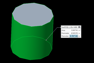

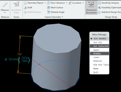

I see.  So sounds like you need to use the Analysis/dimension boundaries function to "force" this dimension to be at the middle value between its limits:
Then you end up with the standard looking shaft fit dimension and also the geometry you want:
Note in my color scheme, dimensions are typically green, but you can see above it is in the cyan color because I forced its value to be in the middle:
This is the same effect as having maintain_limit_tol_nominal to 'no'. It still does not force the drawing to show the correct limits (0.7874/0.7869)

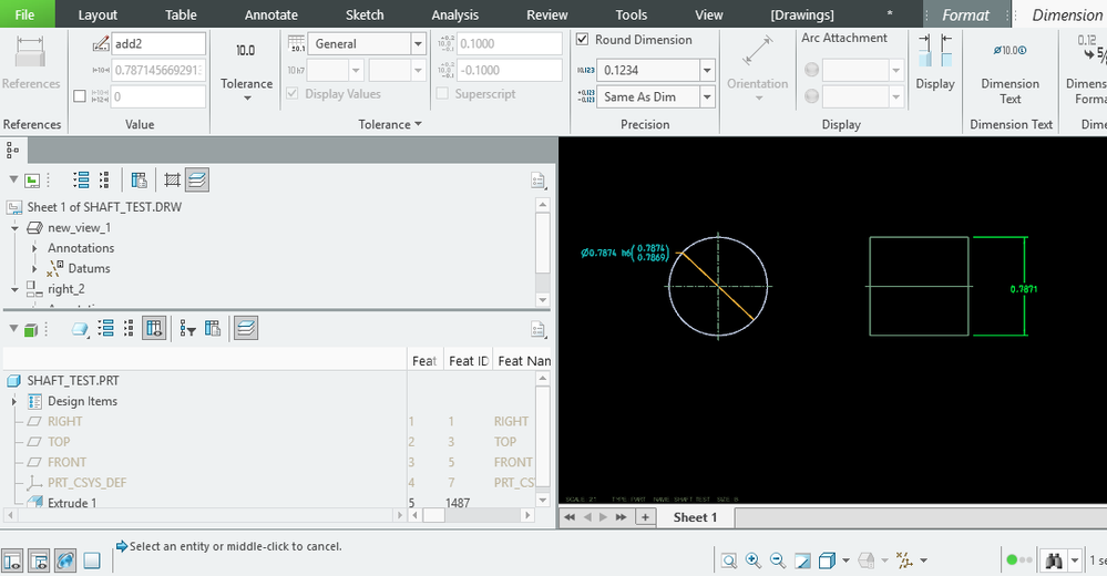

pausob
(To:peterbrown772)
? not sure what you mean.  This is the drawing my above example on my system, with a drawing dimension added to show the geometry at the "median value" and the correct limits (0.7874/0.7869) shown.
