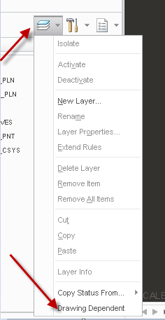

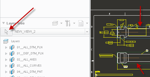

To change a view back to drawing dependent once it has been set to view dependent: (creo 3 although I think it's the same for creo 2)
1. change to layer tree.
2. push the arrow next to drop down. notice how one view has a green outline and one has a blue outline. (on my color scheme, this may vary if you have a different color scheme). green outline means the view has it's own layer control, blue means its layers are drawing dependent.
3. select the view you want to make drawing dependent (the ones with the green outline). If you pick one with the blue outline, it will change it's layers scheme to view dependent.
4. select the layer drop down arrow, select the option drawing dependent, select yes (in the popup) to convert to drawing dependent.
5. repeat for all views that have the green outline. Once all views have the blue outline, you will be controlling all views by the drawing layers.

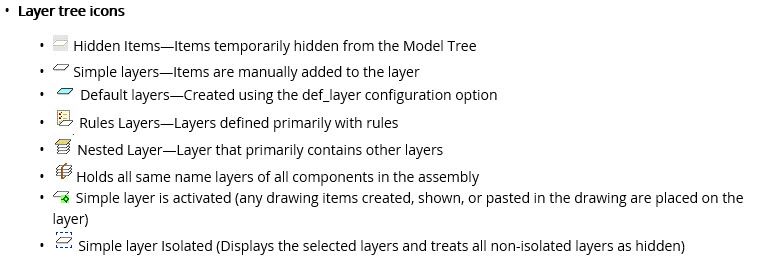

The layer symbols have to do with whether the layer is a drawing layer,  same layer in multiple parts (collection of layers). I'm sure there is a legend somewhere but I don't have it handy.
nalexandru
(To:StephenW)
Thank you for the legend.

(To:mkowallik)
You can not set both for any single view. They have to be drawing dependent or view dependent.
If you want to go faster, go to the assembly and move the insert point to the top. This will temporarily suppress everything. Pay no attention to the displacement or disappearance of drawing graphics, such as dimensions and symbols. Then set the layer status on the views. Then go back to the assembly and Cancel the insert. Then go back to the drawing. Do this just before lunch. When you get back it should all be as you wish.
