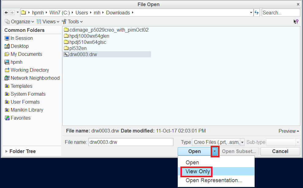

I renamed 1ZSE528002-DE_EMC filter.drw to drw0003.drw
3.)
File > Open > click arrow on Open button and change it to View Only

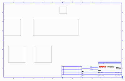

You will see this result.
Over 20 years using this software, I didn't know this option existed!  How long has this been possible?

When I try this the format is still getting loaded and I don't see anything in the drawing views.  Not sure how useful this is...
Edit:  Apparently "save_display" has to be set to "yes" for this to work.  Read all about it here: http://support.ptc.com/help/creo/creo_pma/usascii/#page/detail%2FAbout_View-Only_Mode.html%23
