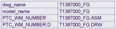

Number is a Windchill parameter.  If you want the file name then use &dwg_name for the drawing's name and &model_name for the model's name.  Neither of these will include the file extension.

Thanks, I knew the answer was simple.
