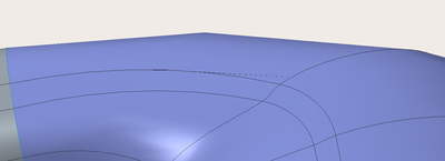

Hello Masters Creo Modelers,
Here in CREO 2.0 M080 ...
In the many topics about Sweeping, i have never found Sweep so straight and short ! ! !
After many tries with Sweep or Sweep Blend, there's not a good surface created by these functions.
I manage to create something with Boundary Blend but it is not enough smooth as I want.
This is the base of the problem. Sweep the ellipse (5x3.5) to the face of the solid !
Even if I create the section just after the selection of the normal trajectory.
Creo don't want to make the intention modeling.
and it reworks the section has you can see !
Does anyone think HE CAN manage to make this modeling ? ?

1> Finally this part is aborted from the update program, so i am just playing to obtain an acceptable result and learn more about CREO as kdirth says 🙂
2> i don't know why it is not possible to have a better/more control on resolution/precision of the model ... the facets are visible ! the option prepare model doesn't improve it, here it is at 0.0001 !
3> ISDX as an option in CREO ... a bit expensive ... so that's why many office engineers doens't hav it .
4> Here in this case of surface with the end inside that is not tangent ... the best way is Boundary Blend ! as managed also tbraxton with ISDX, it seems smooth in picture but after import some facets are on the surface ! but it is better than without ISDX ! !
THANKS GUYS ... in making evolving the subject of surface and at the end the C2 control !
