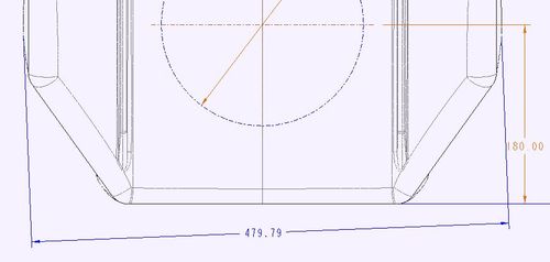

I am trying to create a horizontal dimension to the silhouette curves af a part.  In 2.0 I would get prompted for dimension orientation.
Is there a trick to create the needed dimension in 4.0?

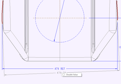

In Creo 4.0, Orientation will change per cursor placement. Try creating dimension and move cursor to get correct orientation.
I have tried that without success.  No mater where I move the curser, the dimension remains the same.  After placement, if I select the dimension, the orientation button in the ribbon is greyed out.
It is acting as though one of the silhouette curves is being treated as a straight line.  I have tried selecting on different areas of the curves with the same result.
TroyHammond
(To:kdirth)
when creating, just before you place it, right click and you have options to set it perp or par to an entity. Try that.
The only option I get is "Double Value".
The 479 REF dimension was created by selecting curve end points, but not the true maximum width dimension.

That's strange. I get, Pick, Query, Horizontal, Vertical, Slanted, Parallel to, and Perpendicular to
I also get many options on other dimensions.  This one dimension just does not want to cooperate.
