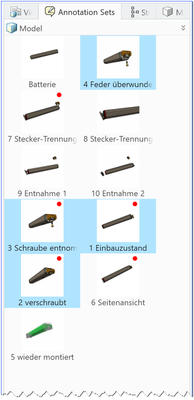

I have saved an assembly in multiple views as annotation sets. For each annotation set, certain parts are in a different position. Viewing the annotation sets one after the other produces a kind of stop motion effect that shows a disassembly of the parts.
How can I create an animation from these six or so annotation sets?
I can't seem to figure that out from the rather brief instructions in the support center.
Namely, every time I click on the next annotation set in animation mode in order to record that next annotation set, the animation mode instead gets terminated?

I have now learned from PTC support that unfortunately it is not possible to create an animation from a series of annotation sets. It seems that animations can only be created within one annotation set.
Now I am still faced with the problem of how to recover those annotation sets that have begun to abruptly change the position of parts and camera when changing to or from another annotation set. In other words, how can I re-enable the gradual smooth transition between all annotation sets?
Some of my annotation sets now have a red dot to them, which seems to indicate that they contain an animation:
However, the abrupt transition between some of these annotation sets does not seem to be correlated with the presence or absence of a red dot.
Thanks for any advice on how I can restore the smooth transition between all annotation sets.
