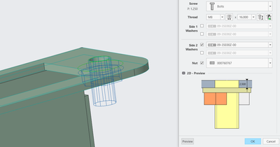

I'm using IFX to create my own custom library.
I've added a few hardware components. Everything is operating OK, but when I use IFX, I do not get the accurate representation of Screw in 2D and 3D previews.
Images are included here.
Please let me know if anyone knows how to fix this.
I did not find anything related to apperances settings in help section.
With custom lib -
With Default Library

IFX only has previews for the predefined types.
If you have a type, which is not available, you can use type 99.
For this type only the maximum outline will be shown.
Together with your own screw icon you will have a good preview.
Hope this will help.
you will find an image with all required dimesions to paint the 2D/3D preveiw correctly.
Here an example for SCREWTYPE 01
Image: SCREWTYPE 01 (ptc.com)

I am looking for some custom representation here like below image ,
I checked to use custom screw using Screw type 50 , also created prt file and template for Screwtype 50 ( attached here, just remove .txt extension). But I guess Creo does not allow custom views like above image and only allow standard Hex head/round head views.

Actually i checked in Creo help and thaught that we can set custom appearance for Screw heads for this screws, but it seems for now IFX do not allow custom Appearance for custom screws, Only Preset appearances -
1) Cylinder Head
2) Hexagonal
3) Countersunk
4) Lifting eye
5) Button head
As an idea, please check possibility to add screws like Flange screw in this appearances.

@Vinayak_Patil as we already have a flange nut we also should add a flange screw.
I will open a ticket for this.
Hope to get this done in near future.
