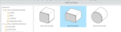

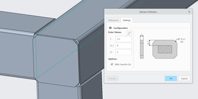

I'm trying to create internal end caps on a framework assembly I generated using AFX. I'm used to being able to do this in SolidWorks (see documentation) but I can't find the equivalent in Creo - can someone please show me where I'm going wrong? Does this exist in a different menu?
The closest I've found is the 'New Equipment Element', but this only generates external end caps and with a chamfer, not a radius. I'm expecting the tool to grab the radius from the RHS profile definition and able to be set internal/external dynamically.
I've tried setting the 'T' parameter negative to achieve something similar but to no avail.
Any help will be much appreciated, thank you!
7 REPLIES 7
If you uncheck "With chamfer" you can use Round on the corners afterwards, as the generated end cap is a solid. It's a manual operation but returns a nice result.
Ideally though, there should be two options in the end cap generator: "With chamfer" and "With radius".

Thanks @SamuelBrantner , happy to hear you are working on this already. To be honest I probably don't use framework enough to be a good test subject, but that is also why I thought I was just looking in the wrong menu.
@EdvinTailwind thanks for the suggestion but my main point was I wanted to find a way to create 'internal' end caps, i.e. those that exist wholly within the profile, which in this case would have also necessitated a radius. Adding a radius to an external end cap would not produce the desired result.

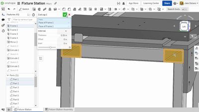

On this topic, PTC have just rolled out this functionality in Onshape.
What's New 1.157 - Frame End Caps
