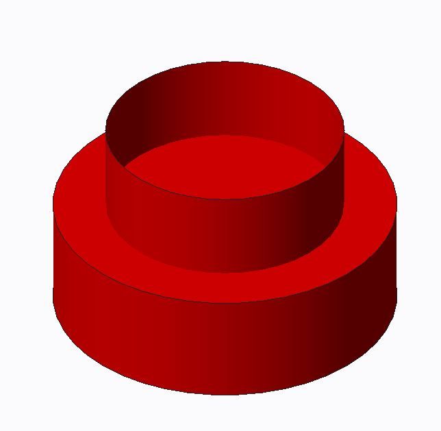

@KenFarley Thanks for the reply. Yes, this would be how I would approach varying surface finishes also, and it works great. However, with this method, when I apply colour to the overall part, surfaces which are separate to the solid body will also change to whatever overall colour I have applied. My question is, can you colour only the solid body so as that other surfaces of that part do not get coloured in the same instance. I've done up a quick model to further illustrate my issue.

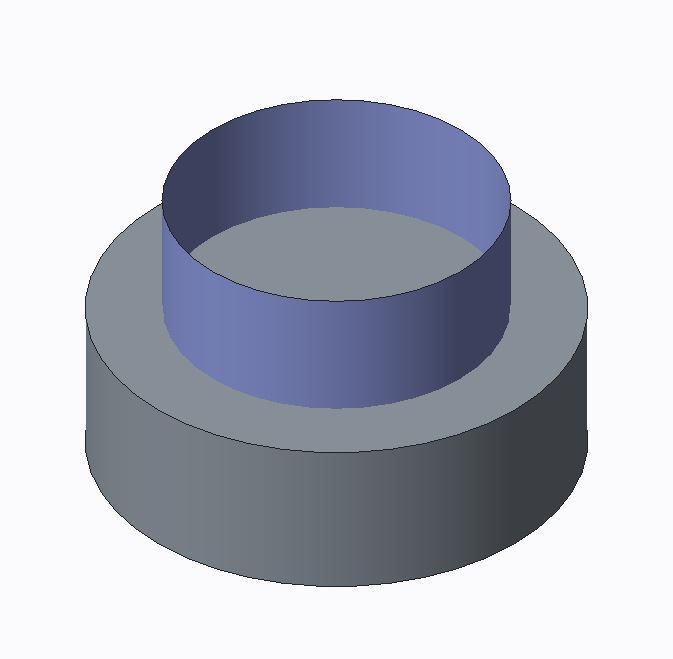

As you can see I have a solid body with a surface running through it which I can use the cut the solid. So, the surface is separate to the solid if that makes sense.
Above is the result I get if I colour the part in its entirety. A quick method but as you can see the surfaces which are not attached to the solid body (i.e. reference surfaces which I use for other features) have now also had the applied colour applied to them.

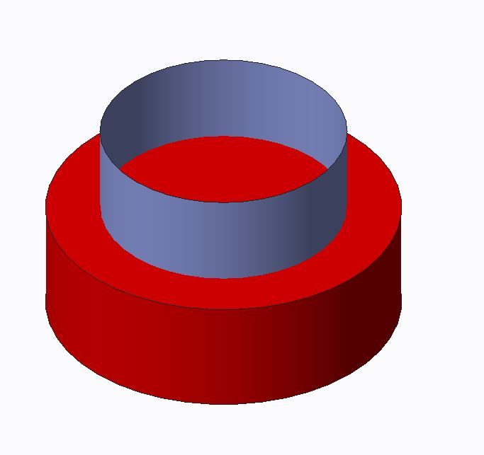

Above is the result I am hoping to achieve. In this instance I have simply applied colour to the surfaces of the part rather than the part as a whole. for a simple model like this, this is an easy task. If I add complexity to this model, colour surfaces individually becomes quite time consuming. In addition to the time taken, any features which are added following the colour application will have the default grey applied, meaning I have to further apply colour to these features which takes more time.
Hopefully this helps explain the query.

If you copy the solid surfaces of the part as a single quilt you can then assign the desired color to the quilt without affecting your reference surf color. You can also change the color of surfaces within the copied quilt if desired. You can hide this quilt at any time as needed.
I use this method to document finishes in the model by color.

This is true if you let the surface be the default color but if you actually set your surface to be a color, you can change the "part" color and the surface will keep the color that was set

That is definitely a solution I had not thought of, coloring the surfaces will still take a bit of time but it solves the issue of additional features not showing the correct colour. Thank you.

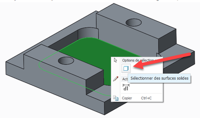

Also, instead of individually selecting solid surfaces, the quick way to add color to the surfaces of the solid model is to select on any one of the solid surfaces, then RMB "select solid surfaces". Its the little icon as shown below. (I stole this image from https://community.ptc.com/t5/Industrial-Design/Select-All-of-an-Imported-Part-when-Copying-a-Geometry/m-p/102863/highlight/true#M1473

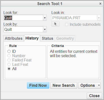

Thanks you @StephenW, Do you know of a quick method for selecting all quilts of a part?
I think you can use Find tool.
Martin Hanák
