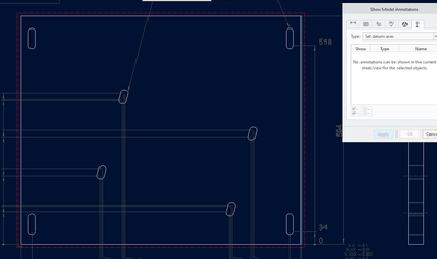

Solution what i have found is,
if i create axis for each slotted holes it will appears in drawing

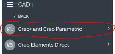

You are in the wrong forum.
PTC has two CAD systems: Creo+ and Creo Parametric and Creo Elements Direct.
Which makes it confusing.
More, for Creo Elements Direct:
- The 3D software name is Modeling, and
- The 2D software name is Drafting.
For Creo+ and Creo Parametric, use only this tab:
You should move your post to this community to have a better chance to get an answer.
To move your post, click on the three vertical dots on your initial post and click on "Notify Moderator".

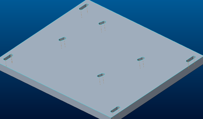

To create specific axes in protrusion, you can also add geometry points to the sketch. Any such point generates an axis in the resulting feature. This can be very useful in situations like when you are creating an "racetrack" slot and want to have an axis at the center of the slot, etc.

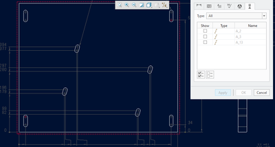

you have to set following config.pro option:
SHOW_AXES_FOR_EXTR_ARCS YES
