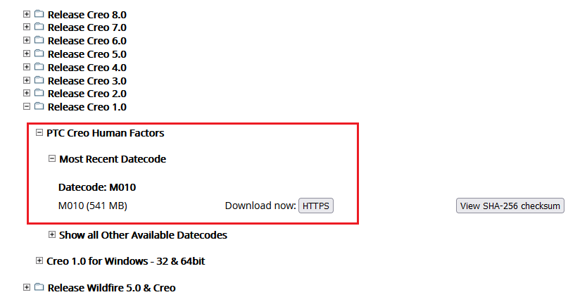

For some reason, PTC has them associated to Creo 1.0 in the PTC software download. You may need to PTC account to download the files.

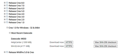

The download location no longer exists as of 2/5/22
TomU
(To:ChrisHanna)
It's still there for me:
