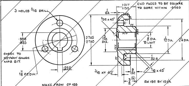

Hello all, I was wondering if anyone could give any advice on how to model a cam track from an old drawing.
I have one idea so far; to draw the profile of the track on a plane and then project it on the outer face of the cam. Then cutting it with a sweep. Unsure if this will work for the whole track, definitely a misunderstanding on my part somewhere. If anyone has any tips, advice or just a better way to do it, I'm all ears.
This is what I have so far.

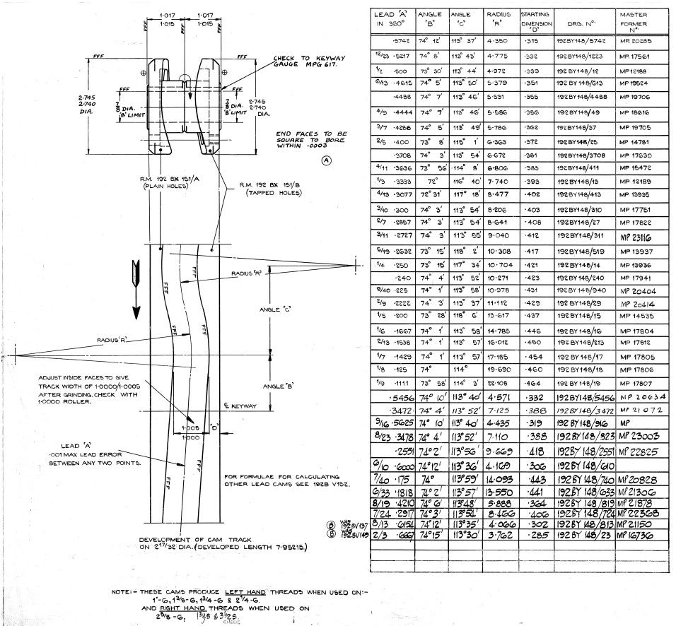

I'm also not entirely sure what "LEAD A" is or how the angles (B and C) relate to the shape in 3D. Perhaps it needs to be calculated to an arc?
I have been using values from the first line,
This is what it should look like in the end.
Thank you for any time you may put in to this!

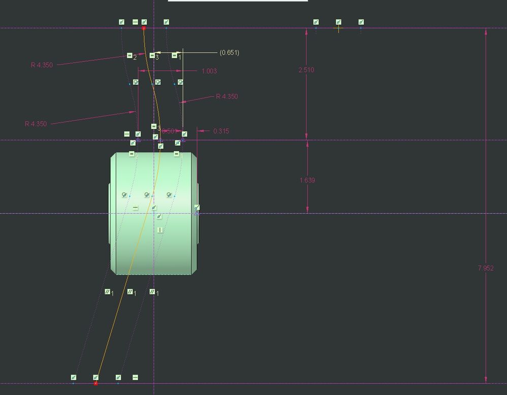

I would suggest starting with creating a parameter for each needed dimension (A, B, C, D, R) to make the other variations easier to create.  Angles would need to be in two parts (minutes & seconds) and converted in a relation (most accurate) or be converted from degrees/minutes to degrees.
Create cylinder
Measure circumference and save as feature.
Create relations for length of circumference, length of angle b, and length of angle c.
Create sketch of CL with relations to parameters and lengths.
Wrap sketch around cylinder.
Sweep a cut.
Here is my sketch:

Projecting from a plane on a cylinder is not going to work for this. The drawing represents the developed surface of a cylinder into which the cam track is cut.  A clue to this is that the developed length of the cam track is given as a number explicitly in the flat view. You can visualize this by imagining wrapping a piece of paper around a cylinder. If you were to draw the cam track trajectory on the paper while it is flat that is what is shown in the first drawing. The angles B and C represent the subtended arc on the cylinder. Think of looking at the face of the cylinder where it is a circle and then you would measure the angle on the clock face (circle) to lay out B and C.
I believe lead A is a specification of tolerance on the track width, but I am not sure exactly what variation it describes. I would guess it is analogous to the lead angle on a thread.
Create a surface for the flat pattern and sketch a curve of the trajectory on the flat pattern and then wrap it around a cylinder of correct radius, you will then have the trajectory to cut the cam slot with a sweep.

I’ve tried creating it based on your description, but I think I’m doing something wrong because the part doesn’t look like it should.
Did the angles converted from minutes to decimals, then used the angle to get an arc length so on and so forth but for some reasons my values are different from yours.
I attached the part, hopefully someone can see what I’m doing wrong.
It’s true with involutes in cad, used to work for a thread grinding company and we spent hours in trying to convert the spline in a thread from to something that the machine could use as an interface for forming the thread grinding stone. In my opinion it wasn’t that it’s not accurate, it’s just that CNCs can’t get splines, they need points, but like with threads or gears a 3d model can be accurate enough to have a part done considering that the tool is done after a true involute and an operator will give corrections in the true involute system. Not impossible but very difficult hence not being used.
Thanks guys, definitely always more to learn.
You are close.  However, the ends of the curve need to meet tangent when they wrap around the cylinder.  If you look closely at my sketch, I have a construction line at the top, tangent to the arc and parallel to the bottom line and the two ends are matched vertically.  Also, you have the top end of the coincident to the center line thru the center point.

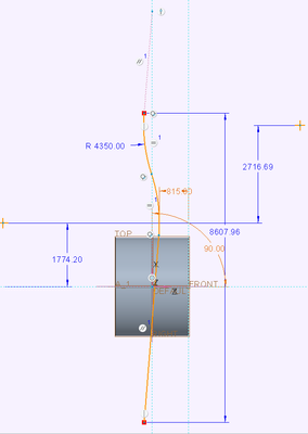

Here is another way to create the geometry that may be closer to the desired shape using a thickened cut.
Adding a sketch CSYS on the center line of the cylinder will help.
LH_10622630
(To:kdirth)
Hi, thanks for the help. All of these replies are getting me closer.
My values are similar to yours but where did you get the value R4350?
That is the radius, first line in that table, but still can’t create the part. Impossible.

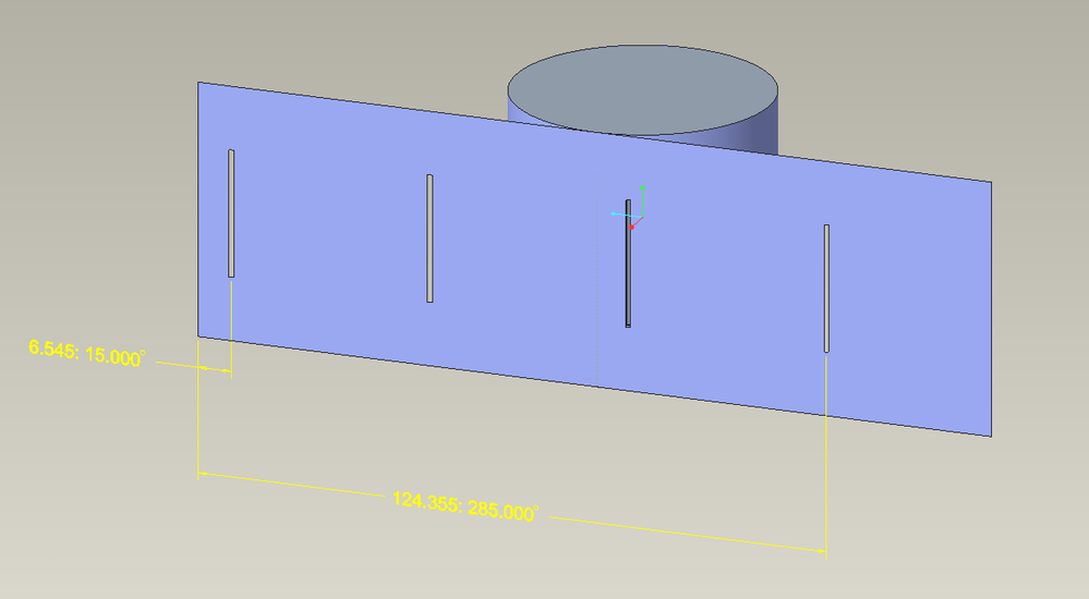

Here is an example of where the developed surface of a cylinder is used to place features at specific locations on the surface in the flat pattern. You can see the dimensions of the developed length mapped to the clocking angle of the cylinder. Zero deg is the left end of the developed surface. This is a trivial explanation; this technique is used to document the location of features on the cylinder wall in a flat pattern format on 2D docs. It allows one to see all of the features on the cylinder in a single view on a drawing.
