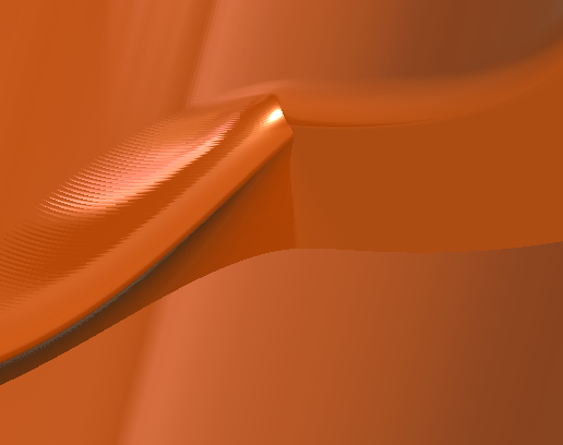

I have tried to make a barrel cam. I have seen previous threads about this topic on this forum. I know that this is tricky geometry and I have tried different methods. I have attached files below with the cutter tool assemblied with a slot constraint to check for interference. There is very little interference but it is there and I want to see if I can model it with no interference. This part was previoulsy made by pattern a revolved cut in increments of .005. This way is not wrong but I wanted to see if I could do it another way. I had seen a previous response by Tim McLellan but I couldnt quite get his method to work. I think the sharper the corner the more the geometry gets distorted.
