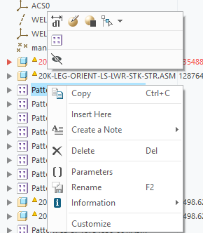

Why would I not get the "delete pattern" option for a pattern?  It's an axis pattern.
I checked placement, it's good. Nothing related to the pattern or the component placement is failing.
I happen to have 4 patterns of the same components and none of them are offering a delete pattern option.
Alternatively, the next 4 different components are all pattern (axis pattern also) and they all offer the delete pattern option.

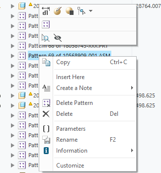

2 images below, first on is the pattern RMB with no delete pattern option
2nd image shows another component with a delete pattern option.

Restarted Creo, went offline, opened master rep and hey, DELETE PATTERN is now available! I thought I had tried master rep before, maybe not...
Went back to online workspace, opened master rep, DELETE PATTERN is available...so apparently I didn't test or maybe opening the rep first, then changing to master rep didn't work, not sure.
In any case, this seems to be associated to the simplified rep I am using. In general, this specific rep is everything, but with the internals of "others" equipment removed to make the model faster and to produce a customer drawing without propriatary internal components shown.
