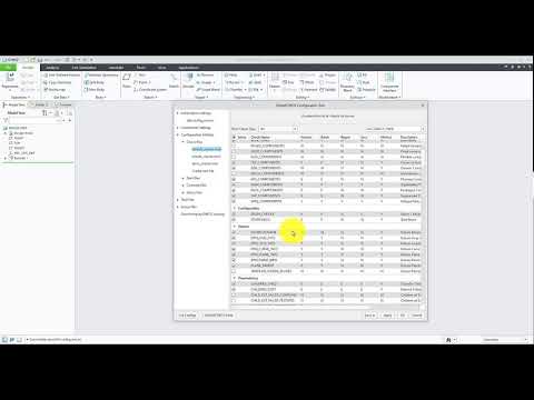

as the others already mentioned, I don't think there is a OOTB solution. But there are two Modelcheck Check Names, called
NUM_COMPONENTS
UNQ_COMPONENTS
which represent the number of components (sum and unique) in an assembly.
Years ago I wrote a nested mapkey (1. regenerate modelcheck 2. OS-script: iterate through the newest modelcheck .xml file, look for the lines with these check names and their values 3. create these parameters in the assembly accordingly 4...) to get number of components in my assemblies. It is possible, but a really dirty solution.
Here is a PTC Tutorial to get the OVERALL_SIZE Modelcheck Check Name as a parameter:
https://www.youtube.com/watch?v=W1WAMeK-NNc
In this video, you will learn how to get the overall size of a model in Creo Parametric. More details at: https://www.ptc.com/en/support/article/CS29792?source=Youtube Need help from community members? See this post: ...
