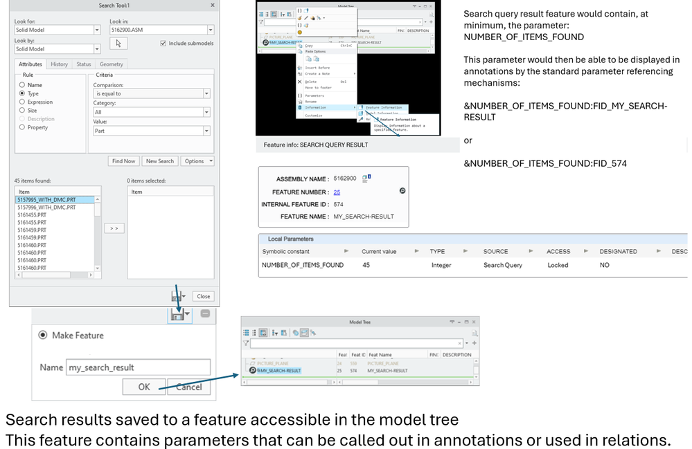

I was going to post an idea about making search results accessible in notes and relations - turns out I can't do this as my PTC Community account isn't linked to an active maintenance / subscription.
Anyway, here's the gist of it:
If someone is interested in submitting this as a Creo Parametric product enhancement idea, feel free to use the above picture.
I submitted this as a product enhancement idea.  Please vote if you like it.

One way to solve it would be with a new added relations funcion:
comp_count(   "assembly name",  [ "part_name" ], [ consider_sub_assemblies ]  )
If used at the part level, the user could ommit "part_name" and it would consider the "self" part name, but would need to specify in which assembly. The third argument would be a boolean to specify recursion to sub-assemblies of said assembly.
If used at assembly level, the assembly name could be ommited, and the current assembly name would be considered, and the part name omitted or specified asterisk " * " to obtain what the original OP requested.
It would be usefull to use this relation at a part level or drawing level to obtain the quantity the said part is included in a main assembly, which the user could specify using its name, or even having another function to obtain the name of the top level assembly in which a part is a member of.
