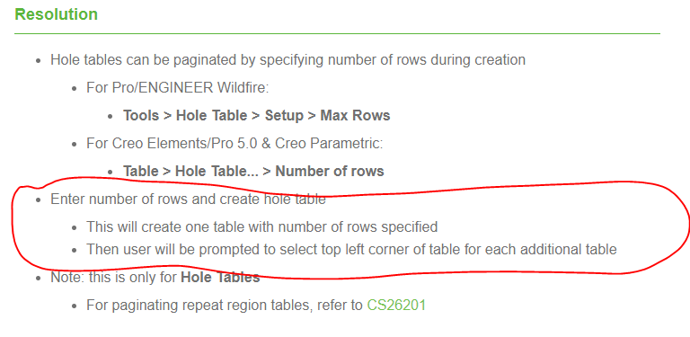

Caught a specific wording:
If I create the table with the number of rows I want, that works, but it doesn't see to allow me to change it after it was made (or I can't get back to the menu to set the number of rows).
Dale

This article is for an older version, but might be worth trying:
https://www.ptc.com/en/support/article?n=CS37250
Dale
