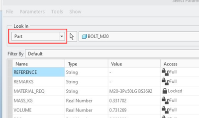

Hi all,
I'm setting up a basic Family Table for fasteners.
I want to add the 'Pitch' column in the family table but it won't let me.
The Pitch parameter is in the generic part but when I click on Add Column - Parameter, it doesnt show in the list for selection.
How can I fix this?

if you can zip and upload your model, you will receive and answer quickly.

I think the PITCH parameter is not at Part level.
Make sure to select the correct feature in the Look In selector.
