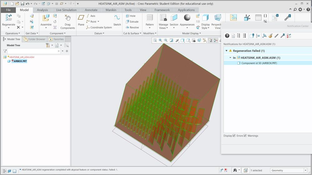

I am working on a project for CFD simulation, which I have to create a solid block to represent the air.
I have tried to use boolean operators to cut out the geometry (or create a negative) from the block. It turned out that the materials were successfully removed, but a warning appeared as shown in the screenshot.
Does anyone know the solution to this?

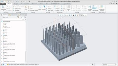

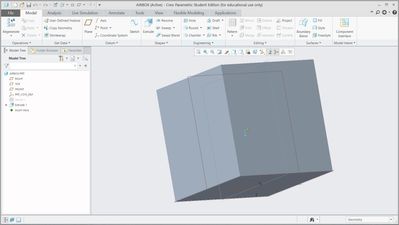

Here are the two parts I am trying to assemble:

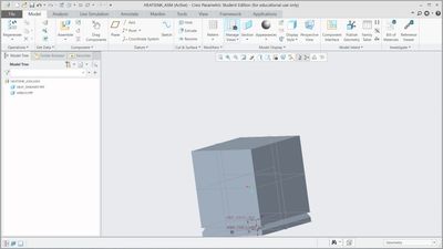

The assembly looks like this:
The boolean Operation I used is to cut; select the airbox as a modified model and heatsink as modifying component.
On the drop-down menu, I choose geometry and manual update, then I uncheck all the boxes except the "discard modifying component" option to remove the heatsink and left the cutouts on the airbox.
Then the regeneration failed warning sign pops-up.
I can still open the airbox.prt file in a separate window and the cuts seems successfully generated, but the warning sign is still present.
I have tried to change the update method to automatic update but still can't solve the problem.

This may be an accuracy issue. Make sure you have saved all your parts before making accuracy changes as sometimes the failures may be difficult to recover from.
In your new part, go to FILE -PREPARE - MODEL PROPERTIES
You may want to make your accuracy a smaller number. You may need to do this to all the parts/assemblies involved.
If that doesn't work and your accuracy is set to relative, you may want to change all your parts to absolute accuracy.
Accuracy issues sometimes cause unexpected errors.
