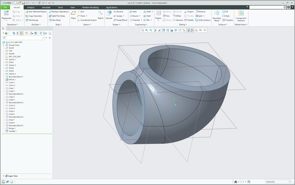

you have to create closed volume before applying Solidify command.
I uploaded video...

Note: Before applying Solidify command all surfaces must be merge into one quilt.

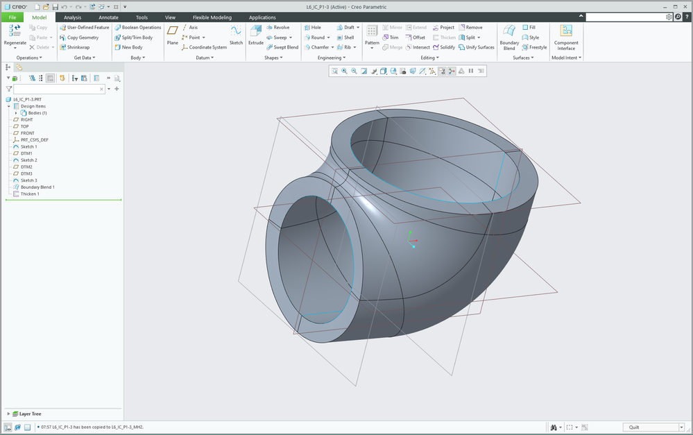

Hi all,
Please find the converted model which can be opened in commercial Creo.
Mark
@SJ_10508956
Thicken command
Adding more surfaces and merging and solidifying
I uploaded video...
Martin Hanák

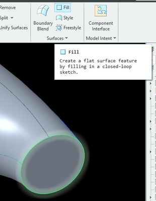

Yes, @SJ_10508956, merge a closed quilt before solidifying it.  The only thing I'd add is that you can maybe use the "Fill" command to create the surface caps for the ends of your pipe (instead of boundary blends as in @MartinHanak video) .
MartinHanak
(To:pausob)
the outer edges of quilt do not lie in a plane, therefore Fill command cannot be used.

In my case, fill does not work on the offset surface. Martin's solution seems to work!
Thanks a lot Martin. I truly appreciate your attention to this matter. The solution is indeed neat. I used the fill command to put end caps at both ends and it worked like a charm...

My apologies Martin. The fill process did not work for the offset surface. Your method worked as per the video.
Thanks a ton with best regards.
This is the solution. Please pardon me for the previous post. Your's work well and seems to be a workable solution. Thank you very much. Bless you.
