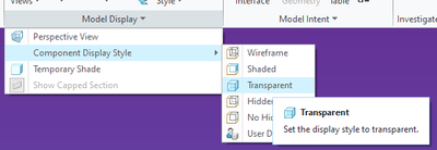

Can you add screen shots of the toolboxes you are using to set transparency or better describe how you are trying to set transparency.
From your description I assume you are using Appearances and selecting a Model appearance to edit the transparency. This will affect any entity that uses that appearance.  Your need to first apply a unique appearance, then modify.
I would also suggest trying Component Display Style>Transparent
Your first screen shot is actually what I seen during pulldown.
So I learned CREO on my own (coming from NX and SW). The second screenshot is exactly what I was looking for - thanks! I need to poke around CREO menus more.
So the first screen shot - I would think selecting part and then editing appearances would only impact that part. This is not the case.
You helped me kdirth - thanks. I will play around a bit more to get a better understand of how to apply appearances. I wish I could select part - right mouse click and edit appearance properties - and only have that impact just that part. The second method is just buried in a drop down. Is there a way to the right click menu? I'm sure there is a way.
