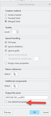

I am using Creo Parametric - Release 7.0 (connected) 7.0 7.0.4.0
in Creo2 when saving as Shrinkwrap, it included automatically the default datums.
in Creo7 it does not, why?
How to fix it?

I'm on Creo 4. When I do, File - Save As-Save a Copy, Shrinkwrap, I have to select "Use default template" to get use my "start part" which included default datums.

@StephenW posted the UI element above. This is the same UI element from Creo 7. Note the "use default template" tick box at the bottom is active. This is what you will need to achieve your goal. In my Creo 7 environment the selection for use default template is active when the UI element is invoked.

ok, something change from Creo2 to 7 when saving shrinkwrap, even when I use "Use default Template", a window open asking to pick the template, it didn't do that with C2. If I choose the template the SW shows datums.
So our automated system creating SW must choose another template.
But why I need to choose a template if I ask to use default?
StephenW
(To:agiaume)
If I choose, Use default template, I don't get the second prompt.
If I leave the use default template unchecked, I get the prompt to choose a template .
Do you have the config.pro option template_solidpart set in your config.pro?

All template_.... show default Creo part.
I need to replace that with our path to existing start_part.
thank you
