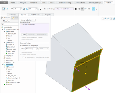

Another way would be to use copy geometry functionality (the way Creo is meant to use to do the things you do with multi-body parts in other programs).
Either do the first part as surface geometry and use it as a skeleton part in an assembly, or just do the part in sheetmetal as you have and make Publish Geometry* to publish the four sides. Then make new parts that copy these surfaces and use the Offset command in Sheetmetal to convert it to a sheetmetal part.
If you want to be extra fancy, you could even make a notebook to store parameters like plate thickness and bend radius, so they are controlled in one place, rather than in each part.
* Publish geometry is not strictly necessary, but it's usually a good idea to keep control over your references and communicate your design intent to others. In this case, however, your part is simple enough to skip it.

That sounds right, thank you!  I just need to get Advanced Assembly extension to use the skeleton functionality.
Pettersson
(To:plos)
Aye, therein lies the rub. I keep forgetting that this isn't part of the basic package.
