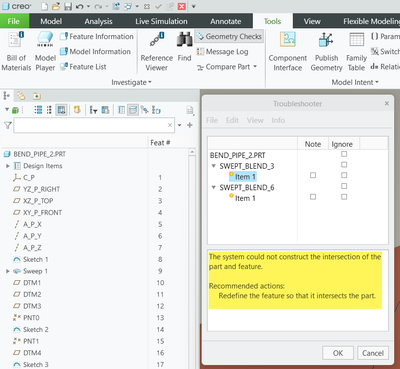

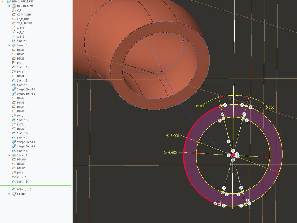

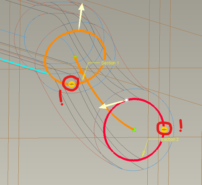

Hi, I've tried to find the error in the problematic sketch, but I can't understand what is the error or where it sits.
Somehow I was able to create exterior swept blend but not internal one with material removal...
Have tried to sketch it identically to the other end of the pipe but the error is still there.
The main pipe track has been copied from another part and rotated. But it works well wen I add paths at one end, but not on the other...

For this type of geometry, I would suggest defining the centerline of the pipe as a 3D curve through space and use this as the sweep trajectory to create the interior surfaces (ID) of the pipe along the entire trajectory. Once you have the inside wall you can then thicken it to get a solid body representing the pipe. Make sure the sweep trajectory is valid for sweeps (Creo requirement) and that the path is consistent with the manufacturing limitations for the pipe (i.e. min bend radius).
The method you are using (swept blend) can be tricky as the ends of the swept blend more often than not will not be congruent with the adjacent pipe section you are trying to use. This is usually caused by the trajectory used for the swept blend not being built to address the alignment of the normal vectors of the swept blend open ends to be congruent with the open pipe ends you need to match.
It appears that the trajectory curves have some issues that are likely problematic. In general, you want your sweep trajectories to have G1 (tangent) or higher continuity along the length, you do not currently have this in your model. By changing the start end of curve 1 to be tangent, the geometry check for sweep 6 is eliminated. Start by creating trajectory curves fit for purpose along the entire length.
For troubleshooting check out the geometry checks in the model. These messages provide some insight into potential issues with your feature geometry.

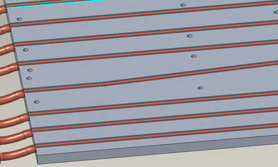

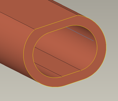

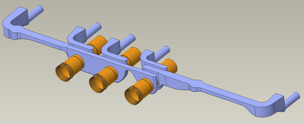

The pipe is made of copper. It is pressed into a Heatsink part along a milled path (that' s why it is flat and not circular in one section). Then, top surface is milled to create one plane:
I need to fit to different geometries along the way, therefore I couldn't create just one path. The final pipe part is obviously different from the previous processing steps, and all I need is to just show the final result. The manufacturing documentation and modeling it from row pipes would be on a supplier side, with all the technological steps and preparations. All I need to show is the end result.

A couple of thoughts from looking at your last pics with the pipes in situ. I see how you can define one continuous trajectory by using the intersection of two planar curves. One in the "plan" view and one in the "elevation" view would yield the entire sweep path for each pipe (assuming they are not identical). I would then sweep a circle section on the entire length and use the thin solid option. If you made a multibody part representing all of the pipes, then you could make one planar cut to add the flat coplanar with the heatsink plate by removing material from all of the bodies with a cut feature. There is no need to make the flat sides displaced by the press fit as those will not be visible but if you need to remove that material it can be done with a body Boolean subtract on all pipes at once by using the heatsink plate as the cutting body.
Using this method would save quite a bit of modeling time relative to adding swept blends on the distal and proximal ends of all of those pipes.

I do know about this way of creating a path 🙂. In my case, I couldn't use it as my cross-section changes from circle to long hole and back to circle. I'm not sure if that can be covered with this technique.
Thank you for your points @tbraxton, the are all valid and useful.
My problem is that at the side shown, all pipes are different due to different positions in a Manifold where they are connected to... It is crazy because instead of just 3 pipes I have over a dozen of pipe parts and it doubles with assembly with fittings .... I'm just rebuilding something taken over from a bought over company that didn't leave any documentation... I can't modify any dimension as we have a bunch of these Heatsinks in storage... I need a proper model for further thermal and mechanical simulations.
I do not love how it is all designed and manufactured, it is what it is... If I would need a new revision of that Heatsink, I will do major improvements and simplifications...

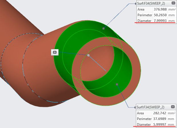

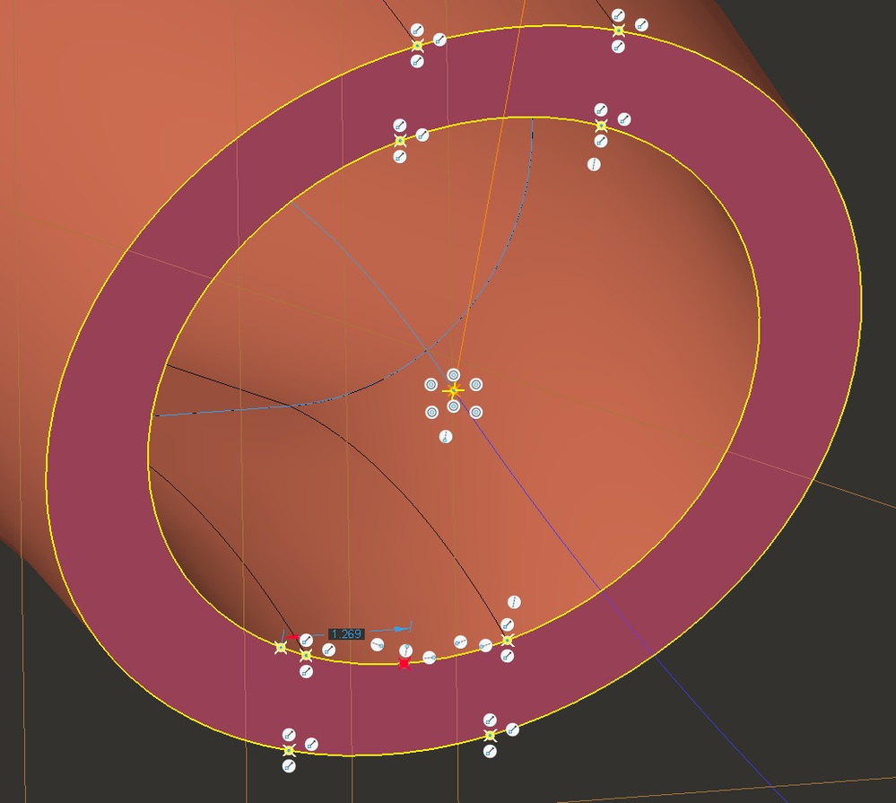

Thank you for the file. I've looked into it and to be honest I can't see any difference between your sketches and mine's.
Can you tell me what did you change specifically?
Screenshot 2025-02-21 092606.pngScreenshot 2025-02-21 122549.pngScreenshot 2025-02-21 122704.png

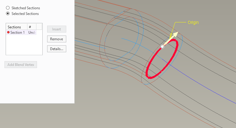

The only difference I see , is that somehow it was possible to properly attach geometries together, see here:
HOWEVER, I didn't even change my file, and was able to do it in the original file, with only difference being, that my Display Style was set to  Shading with Edges instead of Wireframe...
It would be great if you can expand also on why you see the design not being accurate in general. I'd love to learn about my mistakes please 🤔🙂
