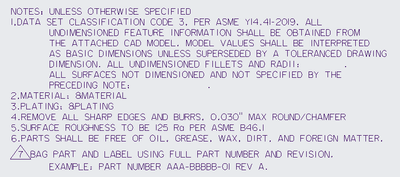

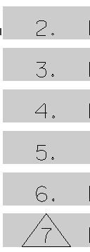

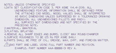

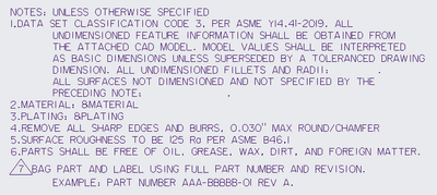

Note behavior in Creo 8.0.6.0. We are trying to get our notes to display embedded sybols as they did in Creo 4. Creo 8 shifts the note text based on the portion of the symbol used. The flag not defines the flag and note numbers. Any suggestions?

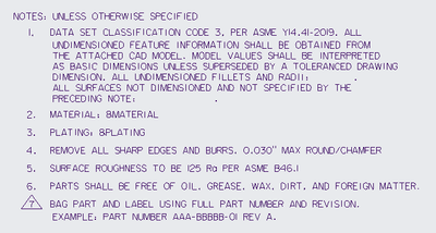

The response from PTC support engineer Michael Bennett that resolved our problem is:
This change is a result of the SPR reported in CS309421.  Any new drawing with the fix applied can be reverted back to the previous behavior using the detail option antiquate_drawing 8712672 then updating sheets. This option must be entered manually and will not autofill. I can confirm that this did apply to your creo8sample.drw and that the creo4sample.drw had additional spaces added to the 1. in order to correct the indentation of additional lines.

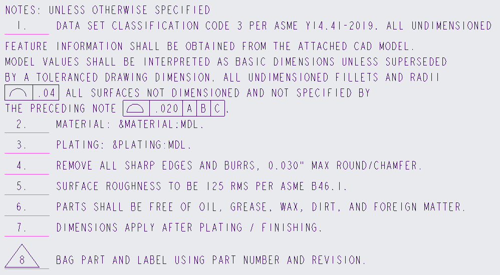

here is the result with the leroy font. - no  joy

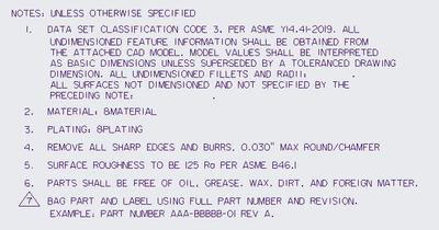

Your file - creo4sample.drw:
Creo Parametric 4.0 M100
Creo Parametric 5.0.5.0
Creo Parametric 6.0.6.0
Creo Parametric 7.0.8.0
Creo Parametric 8.0.7.0
Creo Parametric 9.0.3.0

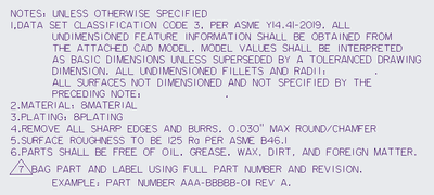

I tried in Creo 9.0.3
Opening the drawing saved in Creo 4 works fine and it is as expected. Copying and pasting the note onto a new drawing changes the behavior.
It appears to me that the bounding box of the symbol changes:
Drawing made in Creo 4:
Drawing made in Creo 9:

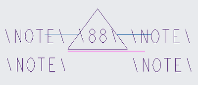

here is the result of my test ...
1.] I opened creo8sample.drw in Creo 8.0.4.0
2.] I added magenta line into symbol definition
3.] multiline note now looks like this ...
4.] magenta line can be changed to white line ... this hides the line on paper print and in PDF export
Martin Hanák
