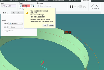

Symmetric revolve 359.75 degrees
SYNDAKIT
I'm pretty sure I could do a symmetric revolve up to 359.9 degrees in previous versions of Creo.
Could someone let me know if that is true?
I am using Creo 8 right now and it's maxing out at 359.5.

The reason this came up is because I thought I could do it before but when I just tried today it wouldn't let me.
I decided to grab some older models to see and yeah I could do 359.9.
Furthermore, I can copy that feature into other parts and it works okay, I just can't create a new revolve feature and rotate it symmetrically 359.9 degrees...... weird.

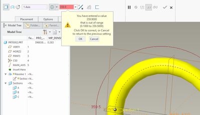

Here is the part I'm talking about:

I went back and double checked and I am now seeing the behavior you described. I first created the revolve using the one direction default with 359.9. I then redefined the feature to be symmetric and I checked the preview and result to see that it still create the feature before I posted.
I now see that when I changed the feature to be symmetric Creo changed the value of the revolve to be 359.5 without notifying me which is very disconcerting.

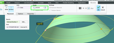

INFO:
In Creo 3.0 M190 I can create 359.99 symmetric revolve using PTC solid_part_mmks.prt template (attached)
In Creo 8.0.0.0 I can create 359.5 symmetric revolve (only) using  the same template.
Please ask PTC Support to explain Creo behavior.
