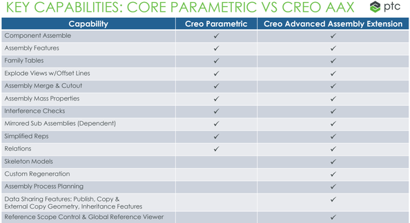

Actually, I found a list in a PTC sales presentation. "Creo Parametric" is a proxy for what you get in Creo Design Essentials:

This is close to what I'm looking for, however it doesn't mention some obvious things like Pro/PROGRAM, Interchange Assemblies, Shrinkwrap... are there any others?

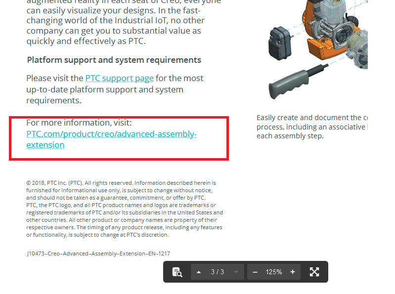

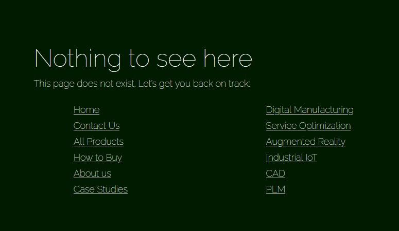

The following link from the doc doesn't work, need to fix it: https://www.ptc.com/product/creo/advanced-assembly-extension
I opened a ticket to have that broken link redirect to a page on the site that does exist...! Should be fixed in no time. Thanks!
