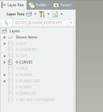

This is what you want to use the projection for? Unhide the layer with the curve and you should be able to see and project it.

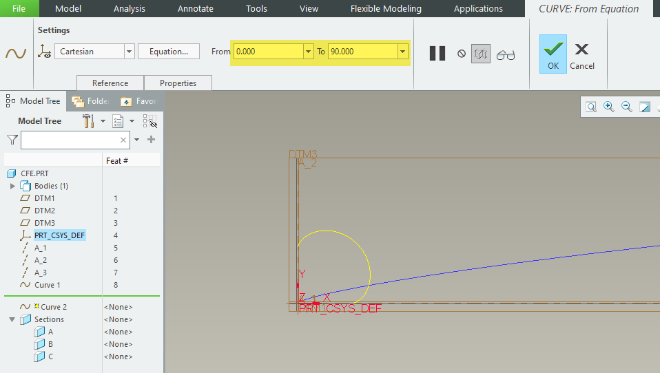

What domain are you using when defining the epicycloid? See example below.
Involute Development, LLC
Consulting Engineers
I am using Cartesian coordinates and I am defining it from 0 to 90 just like you are.
Are the datum curve off screen in the screen shot?
If they are hidden, they can't be selected.
