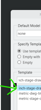

I am after some advice please. I am fairly new to using creo (have used solidworks, inventor and rhino in a previous role), I am trying to remove a template from the list on creating a new drawing. I have navigated to the folder where the templates are saved and this particular template isnt in there to remove, yet it is showing in the list as a n option. Any idea where it would be or why it is still showing?

it looks like web has problems with attached pictures. Please include them into text pf your reply using Copy&Paste functionality.
Martin Hanák
@LR_14430187 wrote:
please check setting of following config.pro options:
start_model_dir
template_drawing
See also https://support.ptc.com/help/windchill/cloud/r12.0.2.0/en/index.html#page/Windchill_Help_Center/ProEWCIntegAHProEConfigOp.html page.
