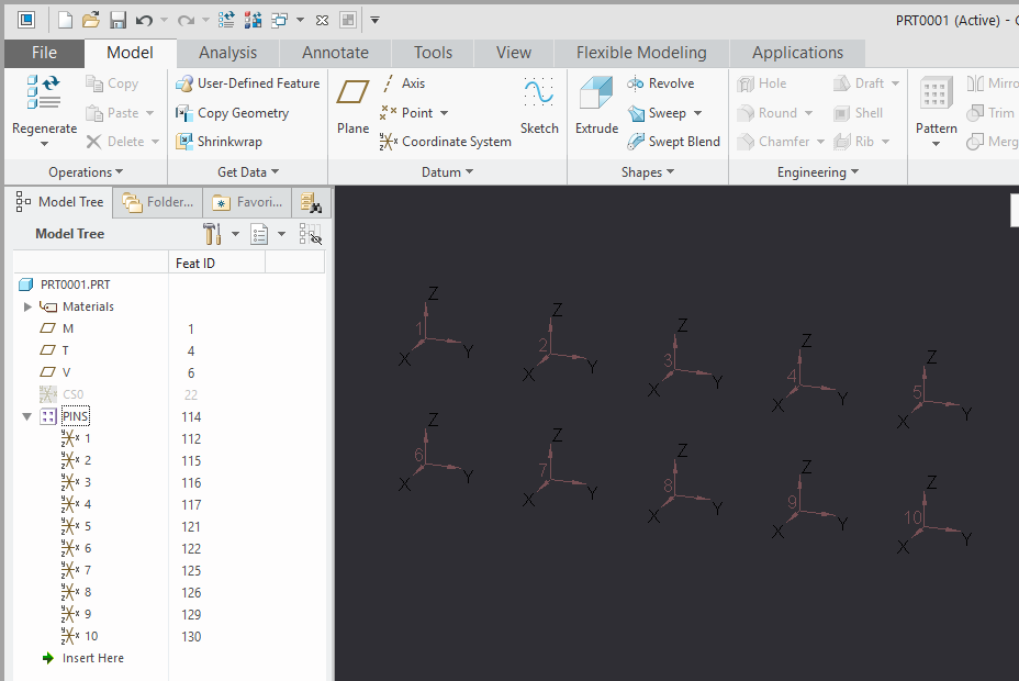

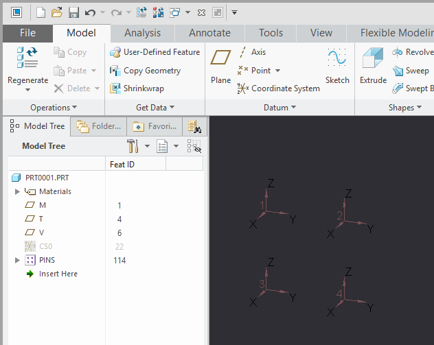

If I understand you correctly, you can achieve this with a Table Pattern.
Here's the 10-pin:
And here's the 4 pin:

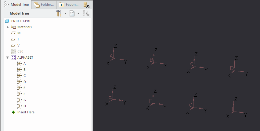

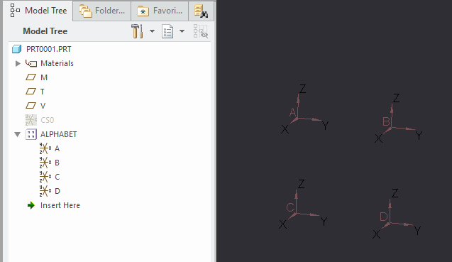

I have a similar problem. When using a Table Pattern, what if I want to name the CSys A, B, C, etc., instead of 1, 2, 3, etc.?
Should work for A,B,C,etc. too
@dmartin

You only need to rename the coordinate systems once (using the largest table). Then you can control where A,B,C,D, etc. will appear.
First left to right, then top to bottom
First bottom to top, then left to right
First top to bottom, then left to right
