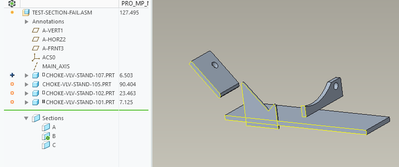

I have a section view with 2 components not showing up in view. They are there but will not appear.
I have tried excluding and including back and forth in VM States tab. I even cleared out my workspace and did the work all over again it was only a (5 minutes task)..
I also created the view state all over again. and nothing.
See screenshot of bodies in green that will not appear.
I did notice in modelling that when I try to add the parts to the section they will not select but other parts will.

I've seen display issues more in regular views than section views, but are the (2) parts in question interfering/overlapping with each other?
No. They actually were present in the view when I originally opened. However, the view state contained extra bodies that did not need to appear in the view. But when I created a new SIMPLIFIED REP the 2 parts do not show up.
Can you check your constraints and verify that the two parts are not constrained to a part that is not in the simplified rep?
Yes. And they are not.
Just curious. Would that cause them to not appear?
If parts are constrained to a part in an instance on which you are not working, then even if you choose to have those parts in the assembly, they will not appear since the parts to which they are constrained does not appear. The logic to constrain them is missing since that part is missing.

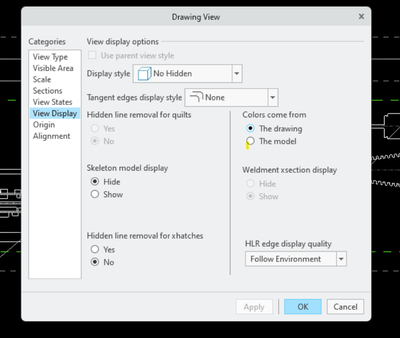

The green parts might be surface models (my surface models are magenta but you may have differenet color settings).
In the edit definition on the section, under the Options tab, select Include all Quilts.
In the drawing, under view properties, under View Display, set Yes for Hidden Line Removal for Quilts
The option is greyed out.
StephenW
(To:Anthony_Zepeda)
Which option is greyed out? Under the view display in the drawing or in the section definition for Include quilts. Also, the include quits doesn't work on offset sections, only planer sections.
There may be a draiwng option, go to File - Prepare - Drawing proerties - detail options Change
Look for Show_quilts_in_total_xsecs  change the value to YES
On a section view in a drawing, surface models (aka quilts) don't section correctly by default...it's an odd thing creo does.

Also, check your layers. A layer that is blanked in the drawing that contains surfaces will make them not show...again, based on my surface model assumption.

In the Drawing View, View Display.
