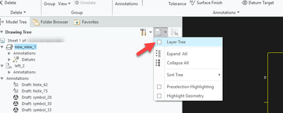

Within the drawing and model, layers are controlled within the layer tree.

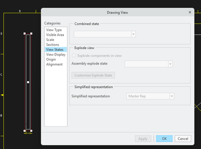

Within a model, if you have set up combined states using the view manager, you can use those within the drawing view under each view properties, then the View States category
