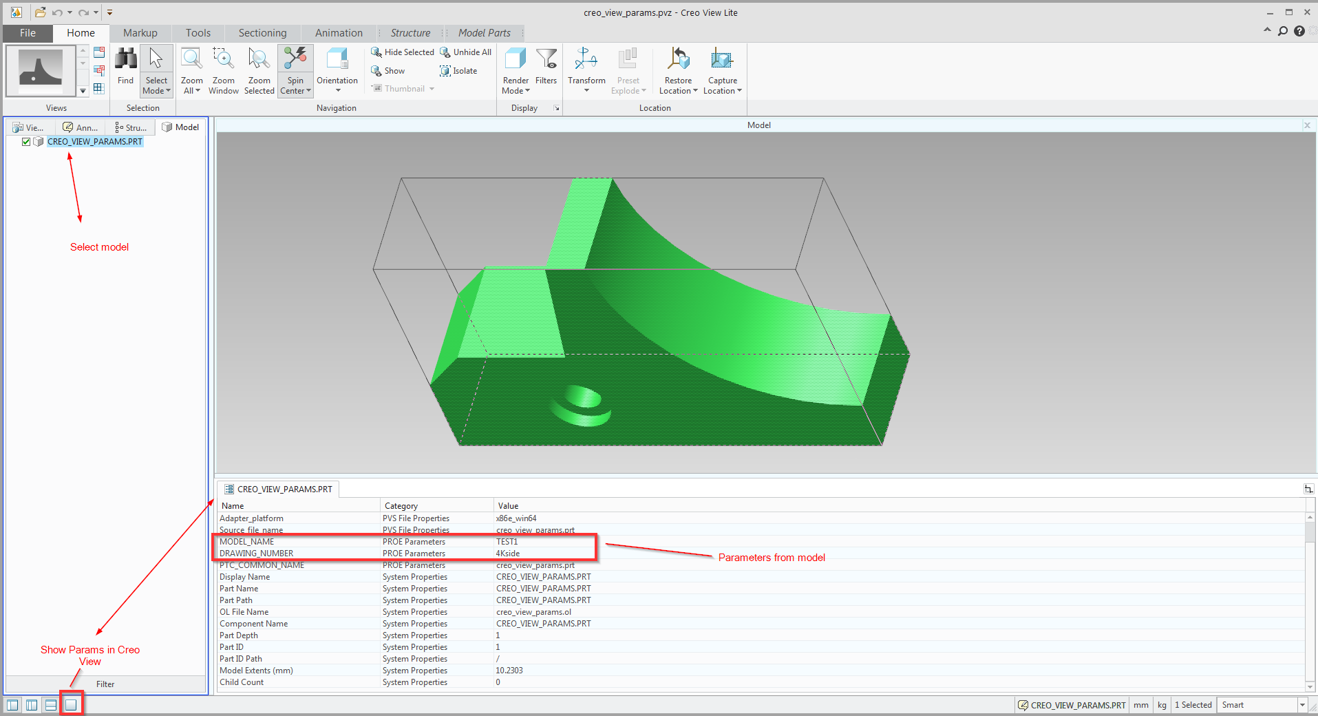

VladimirPalffy
(To:MikeGwin)
In Creo View is possible to see Creo model (asm) parmeters if you select corect visualization Tab:
Best Regards,
Vladimir Palffy
