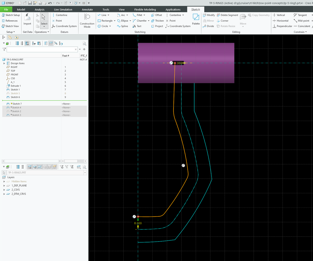

Convert to Taper is grayed out here.  Is there a magic trick to do it with a chain?  Pro/E did it.

That is the current state - as noted by the single entity with a tapered offset.  I have actually tried it with hidden config option both YES and NO.  The screen shot above has the option set to yes.  The offset was created using "Chain".  I also tried it as "Loop" but it is the same.  "Tapered" remains grayed out if I select anything other than a single entity for offset.

@tbraxton So I guess you can eventually get an approximation if you do it in several steps, duplicating sketches, putting in radii where you don't want them, creating a spline, then in yet another sketch create the tapered offset.  It won't combine the curves if they are not tangent.  There was an "exact" combining function in Pro/E, but I can't find that in Creo.
I say approximation because the next step after what you see in this screenshot is to build yet another sketch with the arcs back to sharp corners referencing the geometry of this offset spline.  That will be hard to make it update properly with dimension changes.
