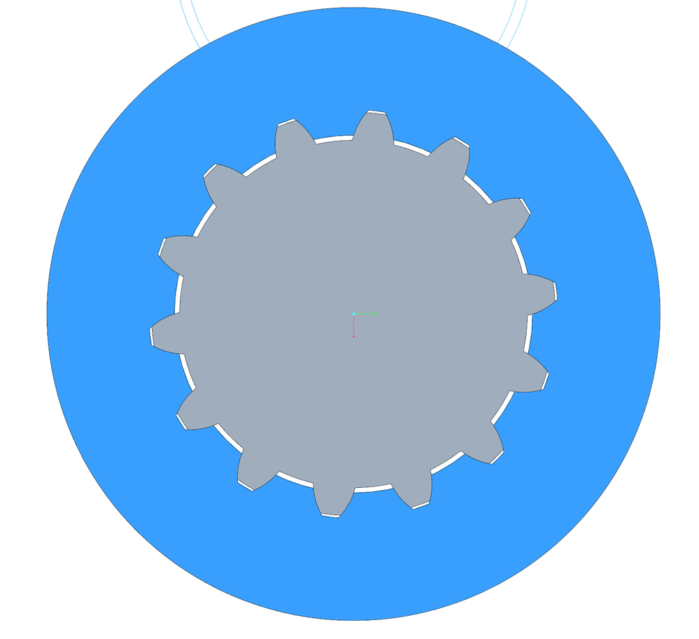

I drawing  2 part:
  • shaft
  • Hub
I want to linked it with gear teeth  (involute profile)
i drawing involute on shaft and hub with the same parameter
when i assembly shaft and hub  i find low profile decal.
in the hub, i use a simple function for cut teeth profile
in the shaft, i use un sweep function
perhaps this decal come from sweep ?
i am sure of my involute
anyone have an idea ?

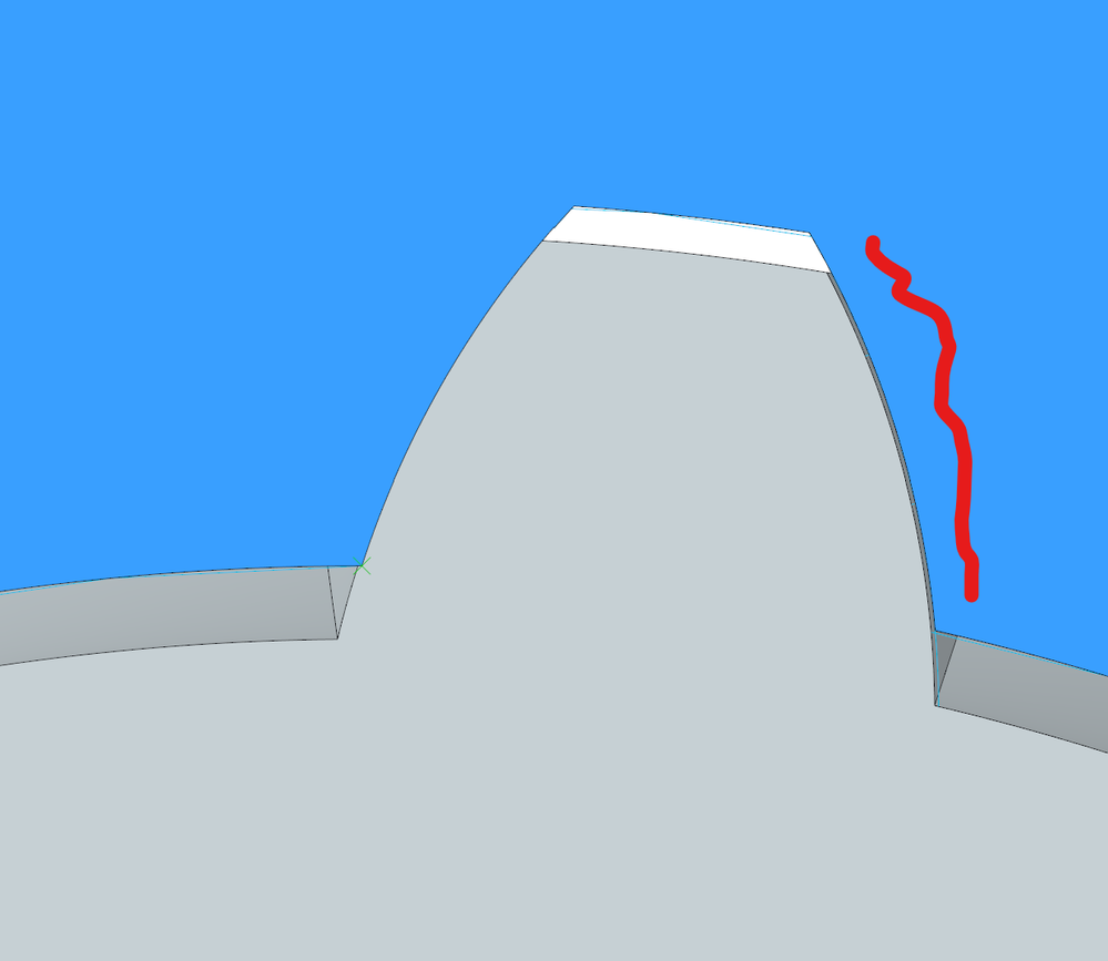

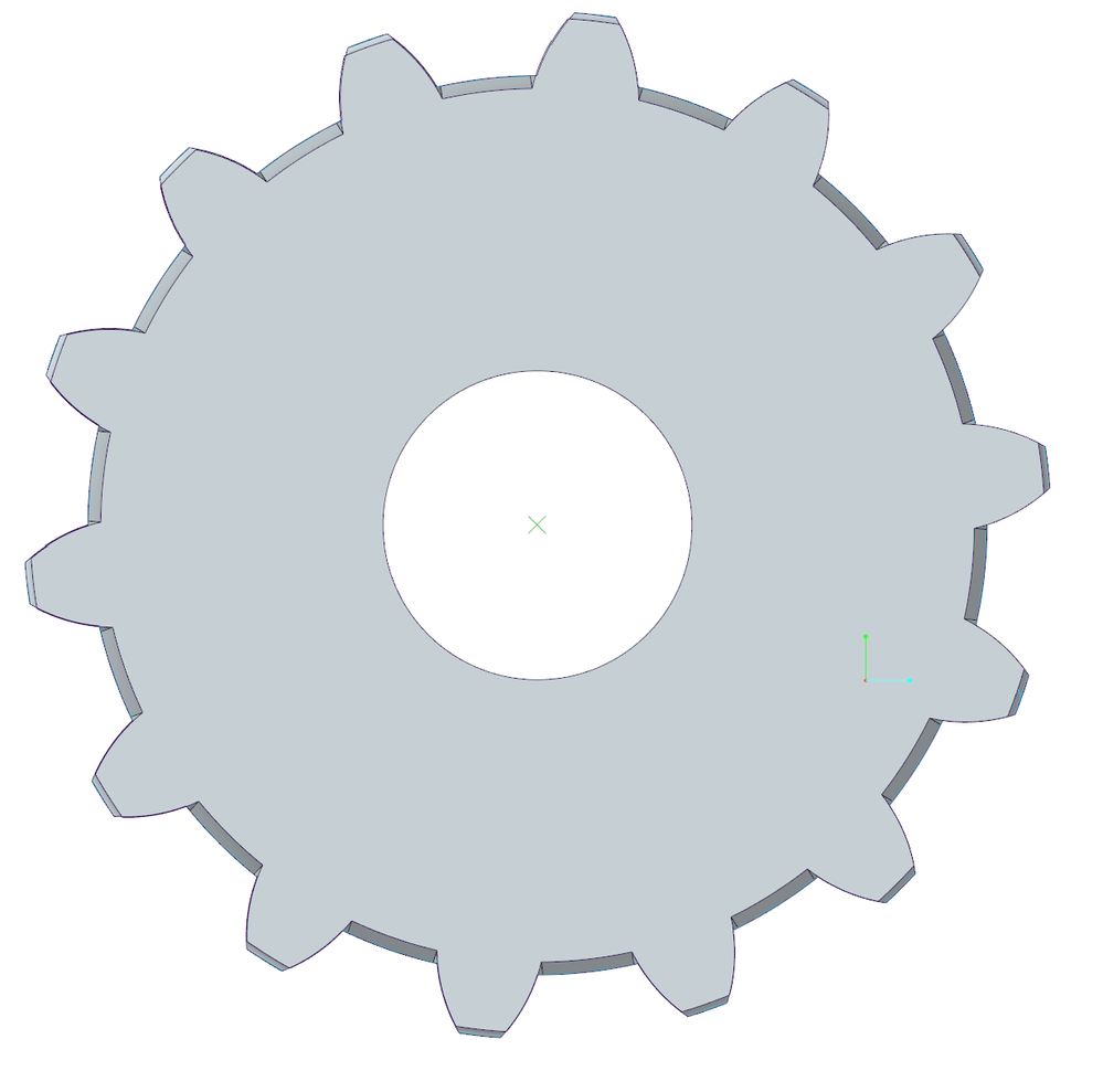

first, i drawing hub and shaft with extrude feature
the involute profile is good, i make it with involute equation
this result is perfect!
see this picture

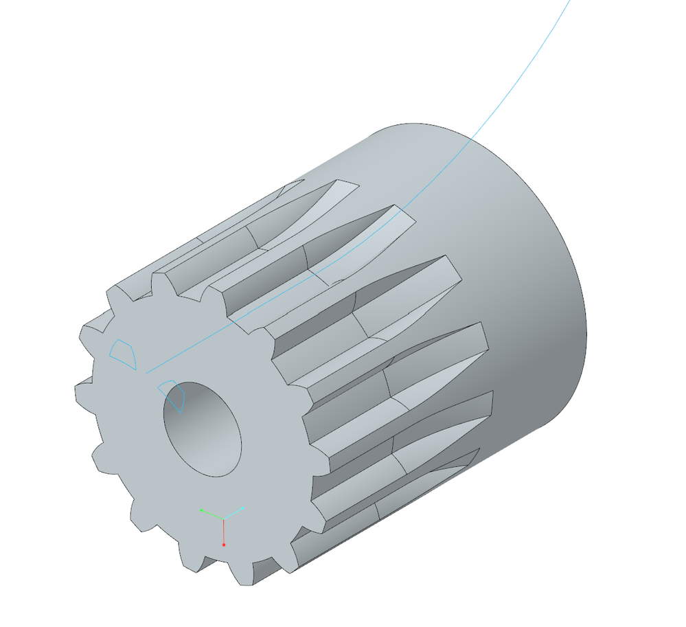

Now, drawing shaft
the sketch is make with the same involute equation
but i use a sweep feature ( not extrusion feature)
because in real life, when i machining the shaft i have the cutting tool geometry

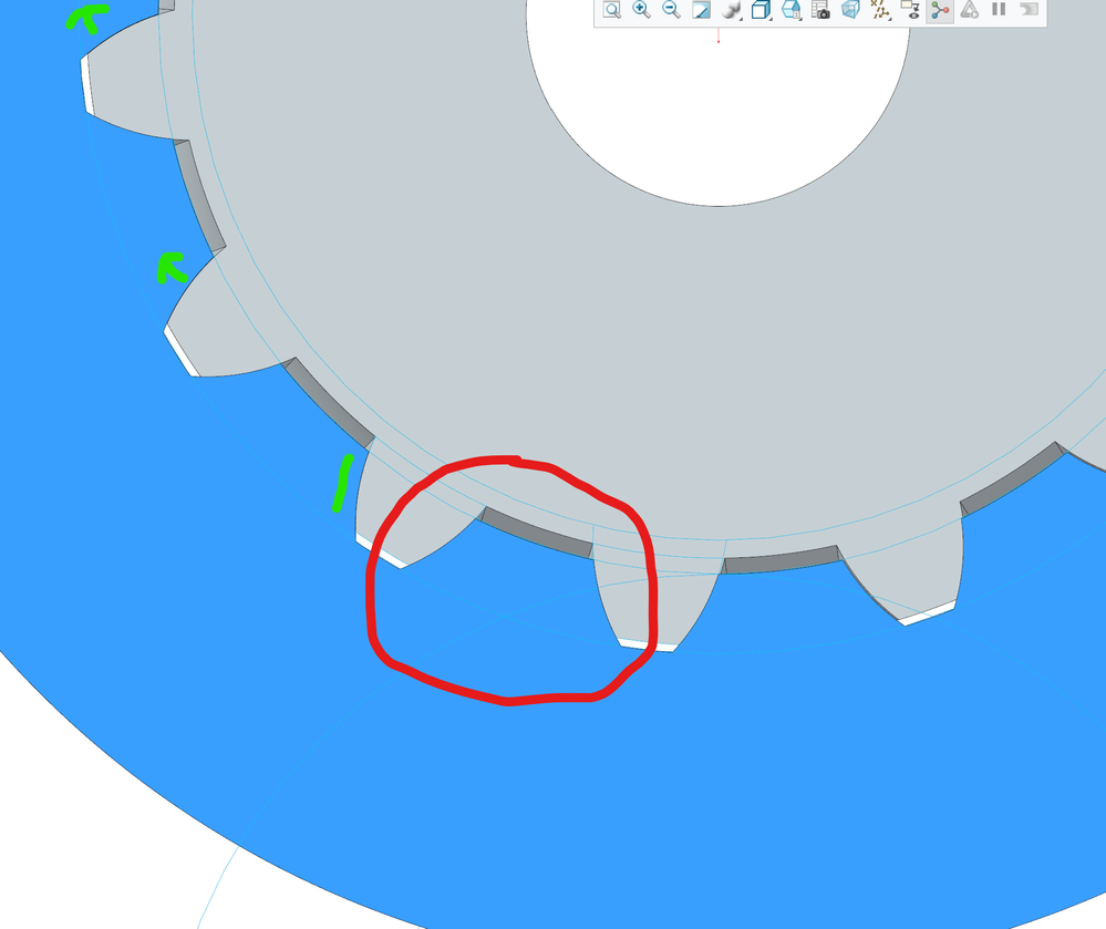

After this, i assembly this part, and now:
i have offset between hub and shaft😱
it is possible th sweep feature make it ?
sweep feature option perhaps
i use Normal To Trajectory
i don't uderstand this options,
Normal To Projection
Constant Normal Direction
thanks

If you look at this part of the shaft, does your sketch exactly match the sweep  cut made?

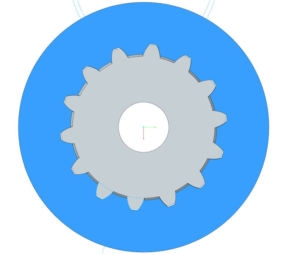

XDN
(To:StephenW)

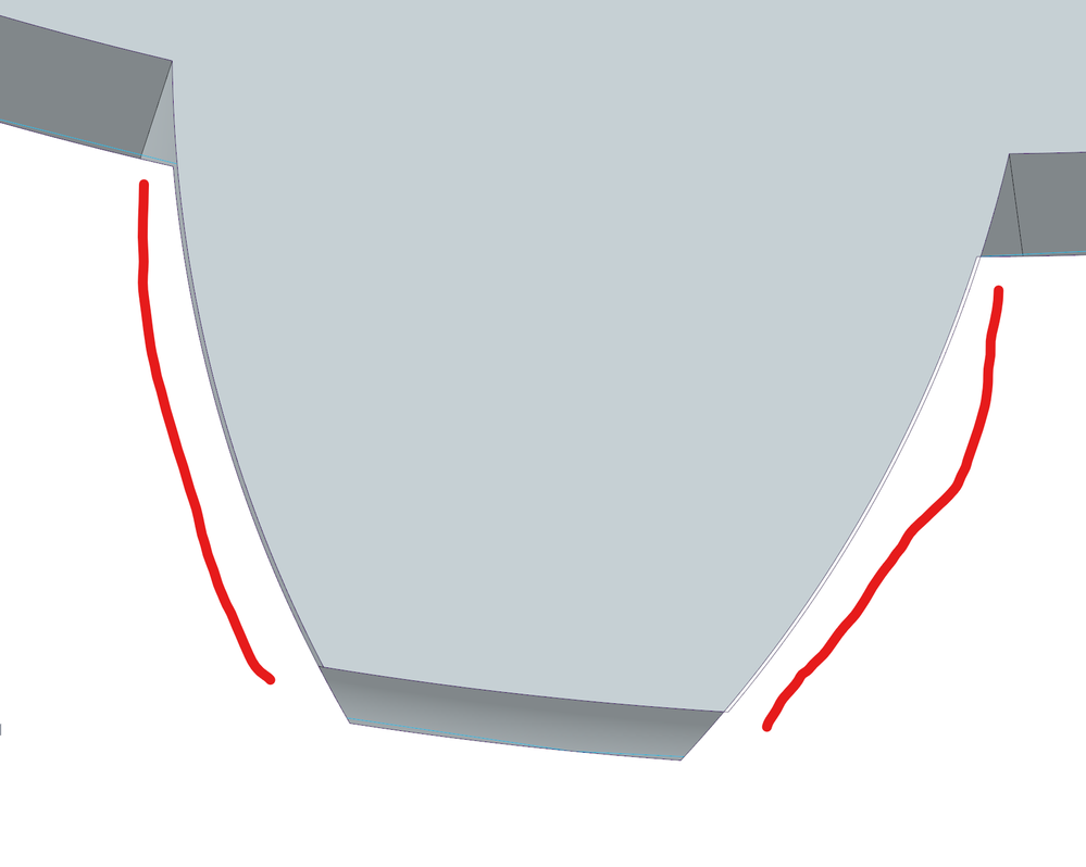

yes, the sketch for sweep feature  is correctly
if this picture, you can see the tooth profile
the sketch is only a copy of tooth edges
the problem appear when i make pattern
but i use a parameter for a right division , not approxymativly angle.
in a first sweep, the geometry is perfect
(red circle)
after pattern, the offset appear, and
It grows with each tooth (green arrow)

If it seems correct on the first one and then shows up with the pattern, then I would expect that either your tooth profile isn't on or thru the center of the shaft or your pattern isn't revolving about the center of the shaft
this image looks like it is larger on one side the other but that maybe just the angle of viewing.

A while back I needed to make  a custom gear with involute geometry similar to what you are doing.
My approach was similar to what you were doing:
(1) Make the involute curve using a cylindrical "Curve from Equation". Curve looked perfect.
(2) Sketch and extrude a single tooth using that curve, and mirroring the geometry about a centerline.
(3) Pattern that tooth to create the full gear.
As you state, I used parameters, calculated the angles and all that.
The trouble is, when I sent the model out to have the wheel built, the wire EDM guy told me the geometry was not symmetric for each tooth.
When I checked into it, I found that by iterating on the gear (changing the number of teeth, etc.) the geometry was no longer the same for both sides of the tooth. The side that was a direct projection of the involute curve I'd defined mathematically still matched, but the mirrored curve in the tooth was not right. It was more approximate, curvature didn't match, etc. What I ended up doing to fix it was to build a half tooth extrusion, mirror that about its center plane, group the half tooth and its mirror, then pattern that to create the full gear. This worked exactly right. Maybe this is of interest to you?
Also, in the past we had troubles with patterns around axes because:
(1) The accuracy (File->Prepare->Accuracy) was Relative, the bad default. I have this set by default in my start parts to Absolute 1.0e-05 inch.
(2) The angular pitch for the pattern has "Round Dimension" checked? This was something that happened when someone was using the dimension on a drawing and set it to round to three decimal places, which really has a big effect when the pattern gets to the 50th tooth. Check to make sure, in your config.pro, that "round_displayed_dim_values" is set to "NO", too.

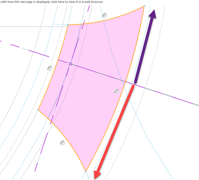

in second time, i drawing tooth not directly with involute équation.
i did like this.
1/ I calculate E .  Is tooth thickness on primitive circle (d=m*Z)
2 / i calculate T . Is tooth thickness on external circle
3/ I calculate Eb . Is tooth thickness on base circle
 After this i drawing arc of a circle passing through 3 points, same line on the other side of the plane of symmetry
If i superimpose the involute from équation, is perfect ! it's obvious, because for calculate  thickness i use the involute equation (tan(phi)-phi)

KenFarley
(To:XDN)
The main thing I found seemed to cause trouble was when I mirrored involute in SKETCH. It seemed like mirror of the spline was not an precise geometry on mirrored side - it acted more like a "one time" mirror, which approximated the true geometry. What did work was I created a half tooth, using the involute curve as solid geometry EXTRUDE. I then mirrored the solid geometry about its center plane and it was the exact same geometry. It seems that the mirroring for solid geometry is precise, but mirroring the spline in SKETCH is not.
All this happened when I was still using Creo 4, I haven't tested for Creo 9. But I suspect it would be the same.

KenFarley
(To:XDN)
Using the CURVE is not a problem.
(1) Make the CURVE. It's really the only way to define the involute.
(2) Make an EXTRUDE, using the CURVE for the side of the tooth. This extrude is a half of a tooth, planar on one side, involute profile on other side.
(3) Mirror this about the planar surface.
(4) Group the extrude and mirror.
(5) Pattern the group about an axis to make the complete gear.
Again, the trouble seems to be that the mirror within a sketch is "imprecise". Mirroring solid geometry apparently is not.
Also, I don't follow the trend I see of people making a sketch, then making a feature. The only time I'm going to make sketch features in a model is if I intend to re-use the sketch for more than one feature. Otherwise it's just useless clutter in the model tree, in my eyes.
