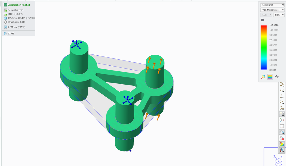

I'm using the generative design application within creo 9 (9.0.3.0). When I've done my optimization and want to look at the stresses in the final design I can't see anything, It's only one homogenous colour. This also applies to the initial simulation results.
I have tried removing all of my config options but that did not help.
Has anybody encountered something similar?

I found the issue. It was that I had changed the opengl config option. Reverting it to standard fixed the issue.

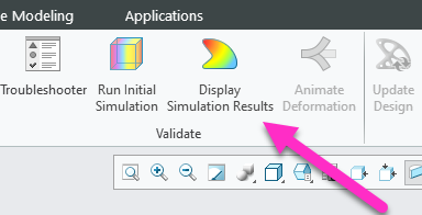

When you click Display Simulation Result, the model is automatically colored based on the color map of the simulation you chose.
If that did not resolve the issue, could you please share your model with the community? That is how we will determine whether the problem you described is local to you or a general problem.
