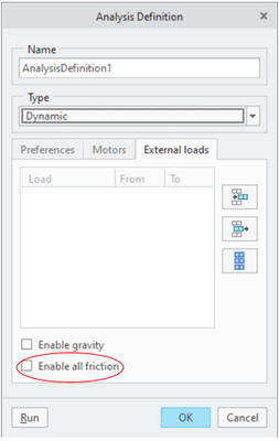

More in Friction balance analysis, it seems to be deactivated when trying to run the calculcations!
There is an "on-off" switch for the study's "global" friction that must be turned on in order for friction throughout the entire assembly to be considered. It's located in the analysis definition dialog box under the "External Loads" page::
